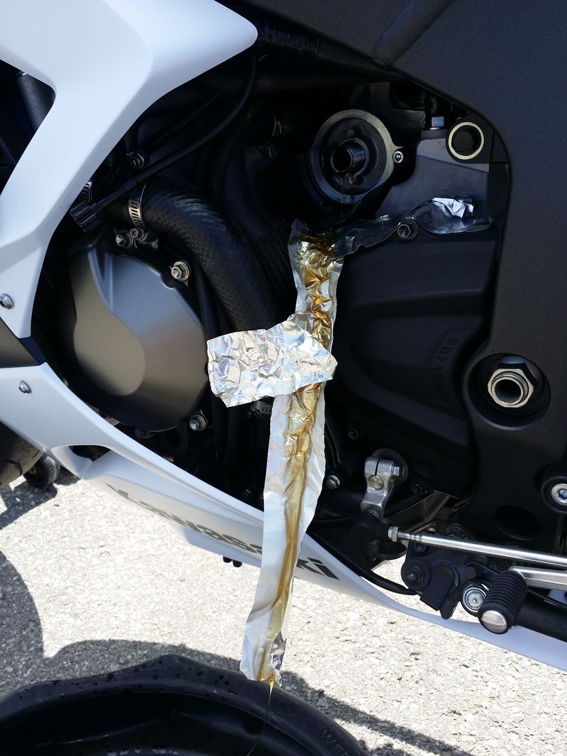

I'm sure there's other people on here that have figured something similar out .. but here's a pretty cool and useful idea for changing the oil filter on your 2013 + zx6r . use this so that you don't spill oil everywhere .
First time ive changed the oIL on this bike, usually I take it to the dealer for warranty purposes . But damn its just too damn expensive ! . As everyone knows lol !! .
So here's my idea . I just used the metal air duct tape to create a channel down to my oil tub ... it worked 100% not 1 drop spilt on my engine or fairings ! . Stupid dealer never cared and let oil get all over the matte fairings !

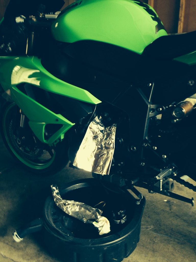

Nice idea. I had some metal left over from an HVAC project and just bent it in a round shape at the oil filter and creased it at the output end. It just drips right over the side into the oil pan. The metal just slides right under the plastic piece under the filter.

I took off that little plastic tray thing under the oil filter because oil would always drip behind it but I pretty much do what you did every oil change.

But the R6 you have to remove the shift lever rod out of the way... and you have that huge foam block under that too
anyways- something to deflect oil passage is always good- direct it to the pan and keep shit clean, better than a big ol shot of contact cleaner over everything afterwards
