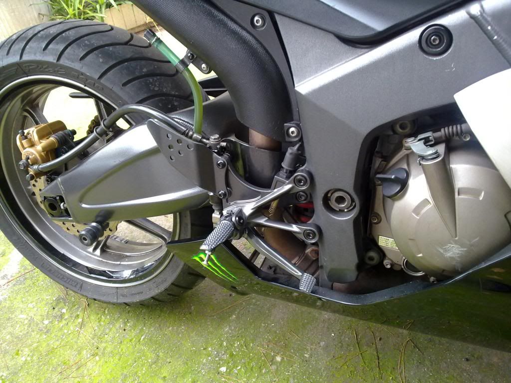

Another thing I should probably mention is when I tie down the bike to the trailer one of the straps just about touch brake fluid reservoir. Could this be that vibration and potholes make the strap to shift reservoir so it lets the air in through the rubber hose?

The update is this. I swapped brake fluid reservoir with a tube and thought that was it. It was not.
I am not going to any track days anymore this season so I winterized the bike and left it lifted on the stands. About a month passed and out of curiosity i decided to check rear brake. it was not there.
obviously the reservoir was not the problem to start with. now the only components left are MC and the caliper. The line can't be the problem as there is no leaks around banjo bolts.
what do folks think, is it MC or caliper?
