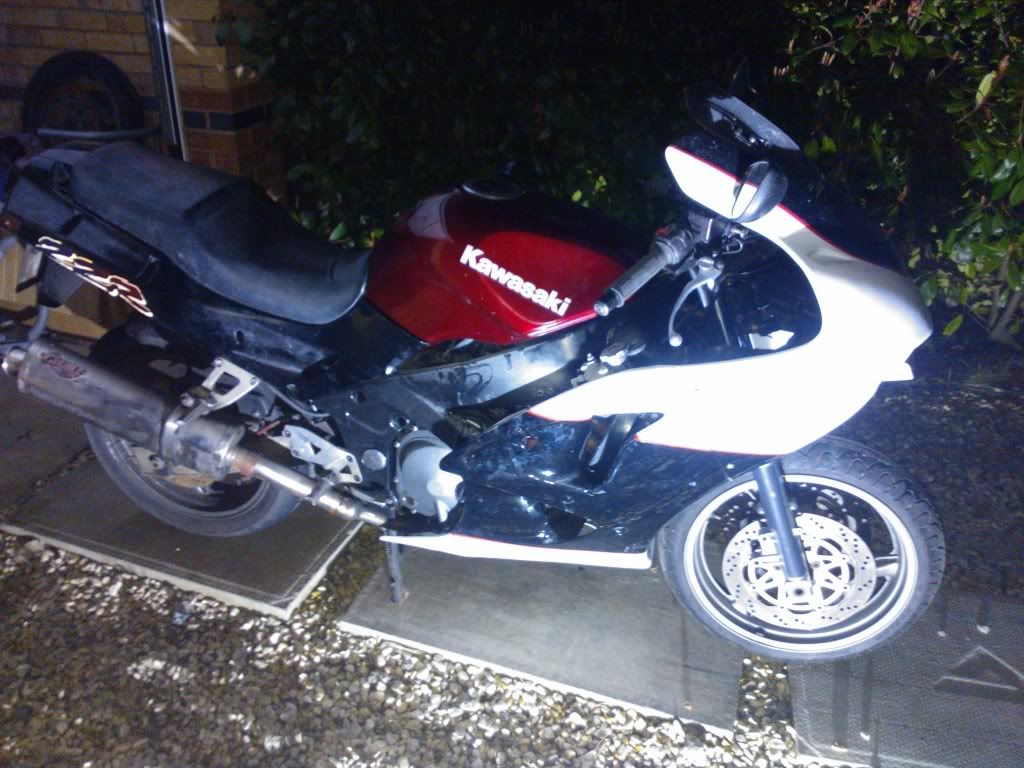

Been working on this for a while, starting to get there now!
All that's left now is to drill a hole to bolt the original J fairing bracket into what's left of a mutilated E model fairing bracket.
Once that's done My fairings will be mounted solidly at the top. Then I'll be drilling and fitting longer bolts down the sides for the lower fairing.
Little bit of All Round Band to secure the lower fairing to the original rear mounts (under the headers).
Stick the R&G's onto the nicely exposed engine mounts meaning no drilling required! :D
Then just need to cut the excess off the air tubes and refit the airbox.
Then switch to the road top fairings and fit my J light (with twin projectors + angel eyes)
New bolt (only one) and spacers for the Nissins - PO used washers, and I had to cut a seized bolt free from the fork leg so needed a new one so I contacted the seller on eBay who does the full kit for ÂŁ12, they've sent me a bolt and 4 spacers for ÂŁ4 :D
Got the rear brake to clean up and rebuild and a new horn to put on.
After all that's done I'll be taking the trusty old (new) Dremel to my clocks and chopping / rearranging them to fit into the J bracketry. I think if I move the water + fuel gauges I should be alright.
Then should be good to go for the MOT on the 14th!
Got a J model swinger in the garage I'm tempted to fit. J model rear wheels seem to be floating around on eBay fairly cheap so I'd be using one of them.
Been offered J forks + triples and mudguard for ÂŁ25 so once I'm back on the road with the ZZR I'll be going to collect them! Bargain :D
Looked into it and spoken to a knowledgable friend; My stem is 5mm too small to press into the J model triples and I was told it'd be bloody expensive to have someone make me a bush and press it in; Ace in the Sleeve - I have a mate with a Lathe and a Press! Onto a winner here!!!
90mm spacing means my current Nissins won't fit; Bandit 1200 Nissins are the upgrade of choice for J forks so I'll be grabbing some of them in good time.
I'll be constantly watching for a G or J front wheel - rare as hens teeth!
Discs are the same so will be able to (thankfully) carry them across.
Due to lack of a speedo drive on the J front (yayy, nice and clean!) I'll be running a KOSO clock very similar to what Chrism (for those who remember him) had on his streetfighter. Current plan would be to run it off the rear wheel but we'll have to see when we get that far!
On eBay I've found various sizes of CNC'd clip ons, think I'll be grabbing them in 46mm for the J forks (anyone that looks into them, the 41mm should fit our standard forks) as the originals are very expensive.
Current plan is to build up gradually over time until I have the whole J front end built up in the garage and then swap over to it.
If money (ever!) allows, I'm planning to have the wheels powder coated in a nice blue. Would like to have the whole bike black / white with blue anodized and powder coated bits.
Forgot to mention, hopefully I'll be adding some Carbon to the build in the less than distant future!!

Before my MOT I fitted my new bracket to the bike and took the chance to finally tidy the electrics up.
This is what I kept from the original top fairing bracket:
Basically chopped the tubular parts coming out both sides off, then chopped the tube out of the top. I also hammered the bottom tube a bit for more clearance.
Once it was chopped, offer up the new bracket (2005-2008 ZZR 600 J - USA model).
Fitted the butchered bracket to the bike's headstock mount. Then put the new bracket inside (it's a squeeze) and fit the whole fairing.
This bracket let me fit the J model fairing, with the much improved dual headlight, and mirrors you can actually see something other than elbow in!
The fairing is fairly secure without additional points to mount to as the left side sits tightly on the generator cover. I chose to use an M5 allen bolt through the side of the fairing into the hole in the frame that the little trim panel normally connects to. This made the right side as solid as the left. Unfortunately I cocked up, and now have an extra 5mm hole I need to fill in in the side of my fairing - D'oh! Easily fixable anyway.
I mounted mine as I've said above, and it went through the MOT today!
