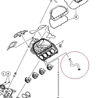

Do the smog block offs.... then remove the entire smog system. Only things you'll need to leave connected are the crank case rebreather hose going up to the airbox. ANd the small oil overflow catch from the left side of the airbox. The rest of the smog shit can be pulled out. I have ZERO immissions crap on my bike now.

No... the crank case rebreather is on the back of the airbox and routes pretty much straight down into the crank case. It's a pretty large hose actually... can't miss it. Has probably a 2/4 inch hose. You should be able to see it even with the fairings on the bike.
#18 ·
Ok yeah I know what you're talking about. I'll follow up with the service manual and track all of the pipes. So basically, my shopping list should be a set of block off plates, and 3/8" vacuum cap for the airbox and 1/8" for capping where CA emissions pump attaches to the radiator?
