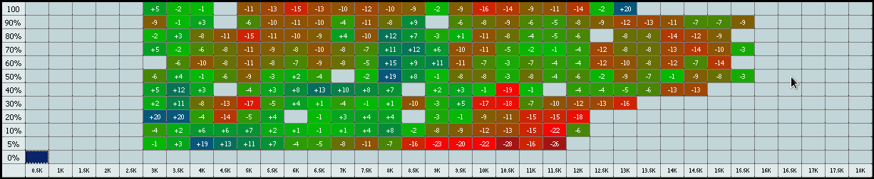

So my stuff came in the mail yesterday. I installed it last night and luckily enough there is a sunny day today and it's a lovely 40 degrees out. So I took it out for a ride around the block (5 miles through the country where I could open it up several times). I realize I probably need to get a good full session on the track but I'm just trying to figure out how everything works and how to make the best adjustments. The first image below is the default map that came in the unit for my bike and the 2nd map is after I rode it around the block, retrieved the data and applied all. I didn't do any smoothing yet and am just curious if that 2nd map was after a good run what would be the suggested changes/smoothing in this case?

There are a few cells that have rich numbers like a +20 next to negative numbers, those could be anomalies, but I'd take it for another mapping run before passing judgment. As for the QS, it's odd for it to become intermittent like that, esp when it's brand new. I've never seen the connection go bad, where the switch plugs into the harness, it's usually something else. I'd check and make sure the gear ans RPM signals are reading steady inn the software, then call the Bazzaz Tech line and they can walk you through some more diagnostic steps.
