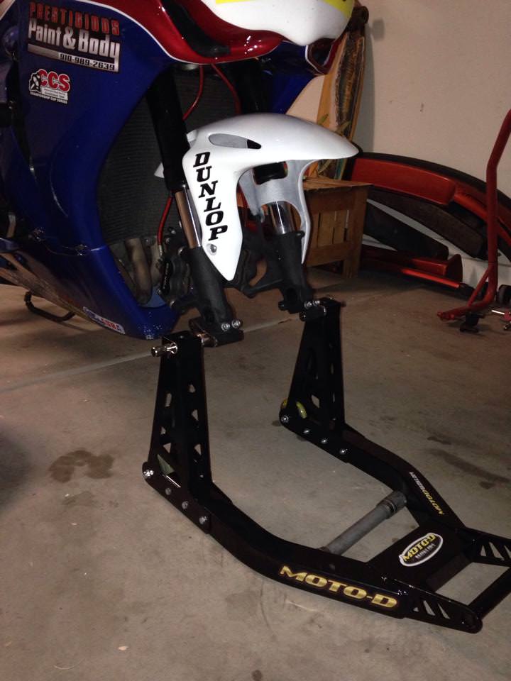

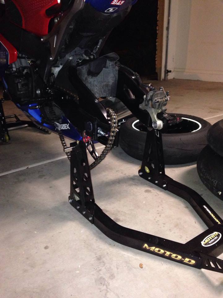

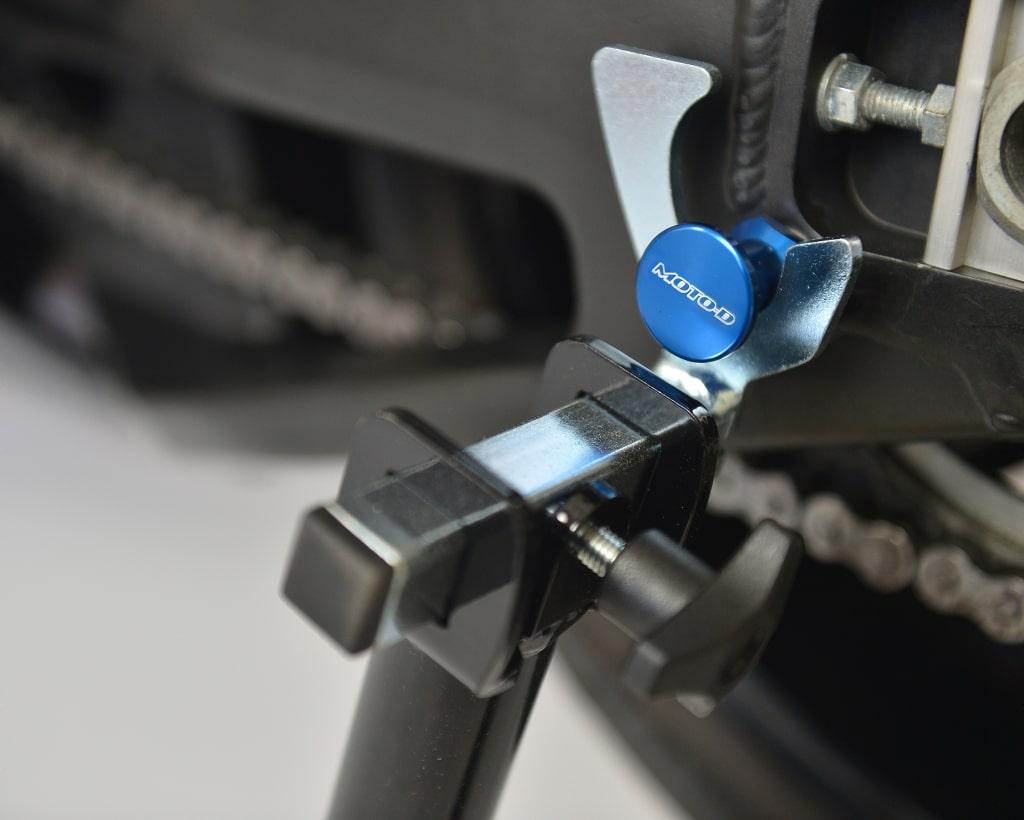

Moto-D Racing sells a pair of stands for $140 for the pair shipped to your house. Well worth the investment.
Moto-D Racing also offer spools if you need them
