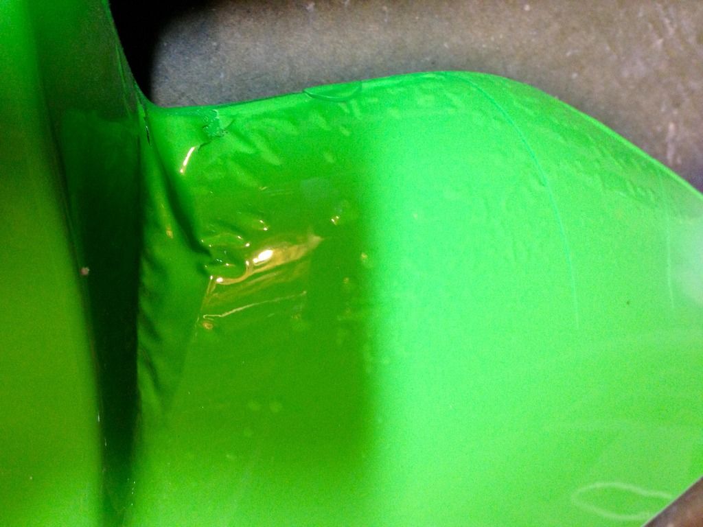

Paint Bubbled

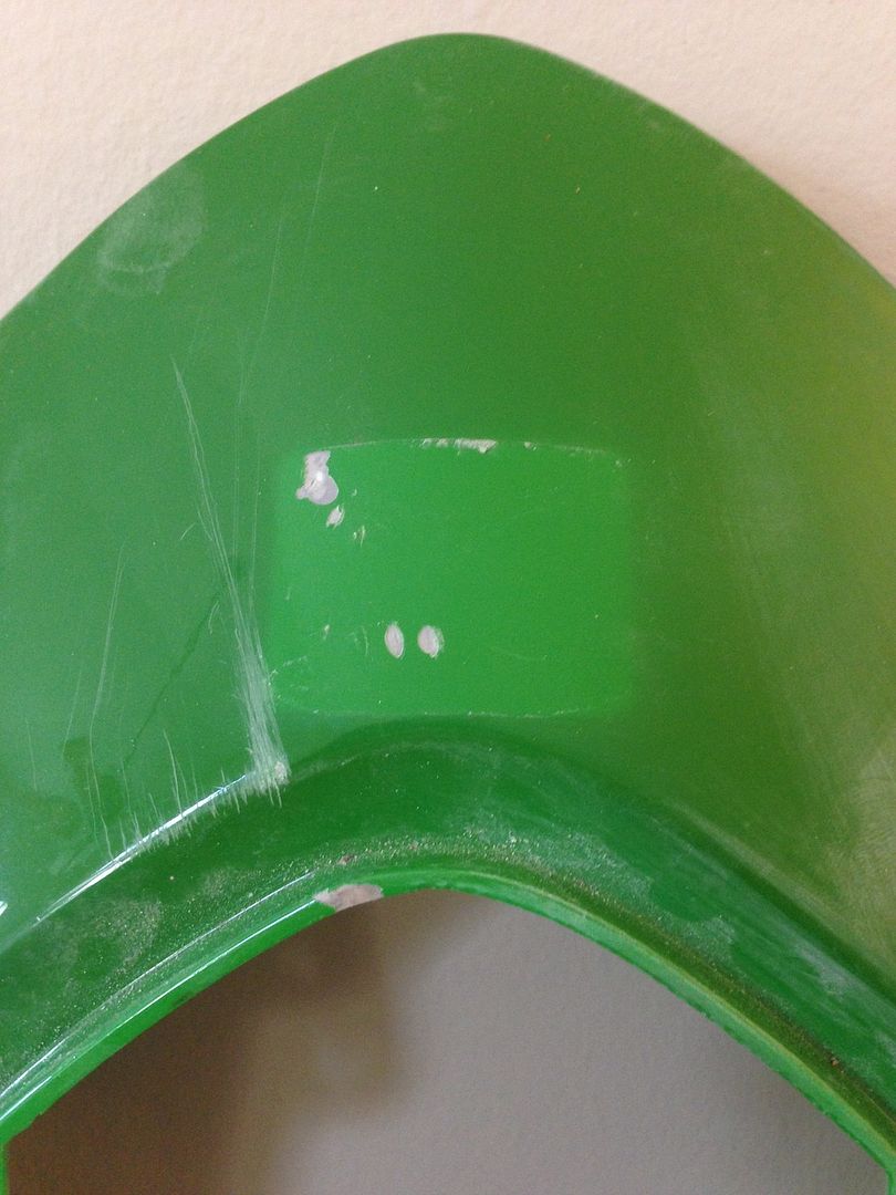

Anyways, I started sanding them down...
The chinamen clear over the decals so it has been fun sanding them off. Used 60 or 80 grit to strip these.

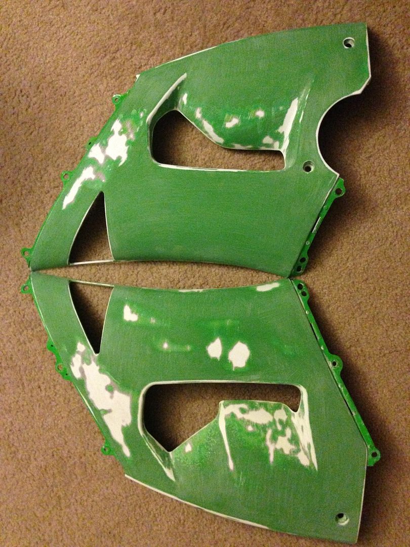

These have been hit with finer grit (600 I think) and are pretty much ready for primer which will be happening tomorrow. Nose and tail pieces are still work in progress on the sanding.

This might sound stupid but do your aftermarket fairings have the heat absorbing foam on the back of them? If not you'll probably run into the same fate that the original paint did from the plastics becoming too hot and moving/flexing. If you don't have it, get it, they're fairly cheap, even from the dealer.

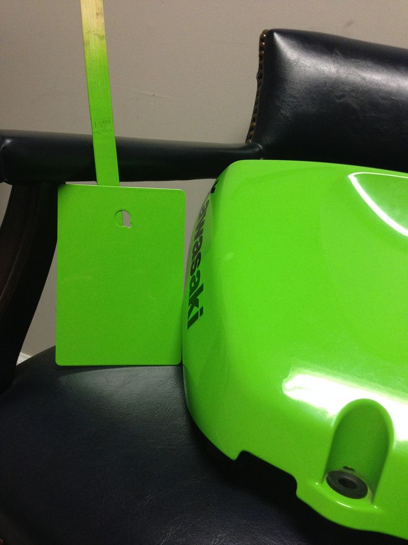

Decided that I do not want to pay for colorrite's expensive paint so I set out to find an alternative. After some searching I found a single stage paint that might do the trick! Here is the spray out card compared to the OEM tank fairing that I am looking to match. Looks pretty good to me! Now time for wet sand and paint!

Two questions:
1) What color was that card before you painted over it?
2) Does that card have clear coat on it?
The answers to both of those questions WILL affect the final color of the paint and could VERY easily make it not match after you're done.
Otherwise, looks pretty good - hopefully it'll turn out looking as good as that card :bigthumb:
Two questions:
Thanks for the heads up. It is single stage paint so there is no clear coat.

fwiw, lots of people still clear coat over a single stage paint (especially if trying to match something that has a clear coat on it...like your tank) and it does still matter what color you're painting over :O

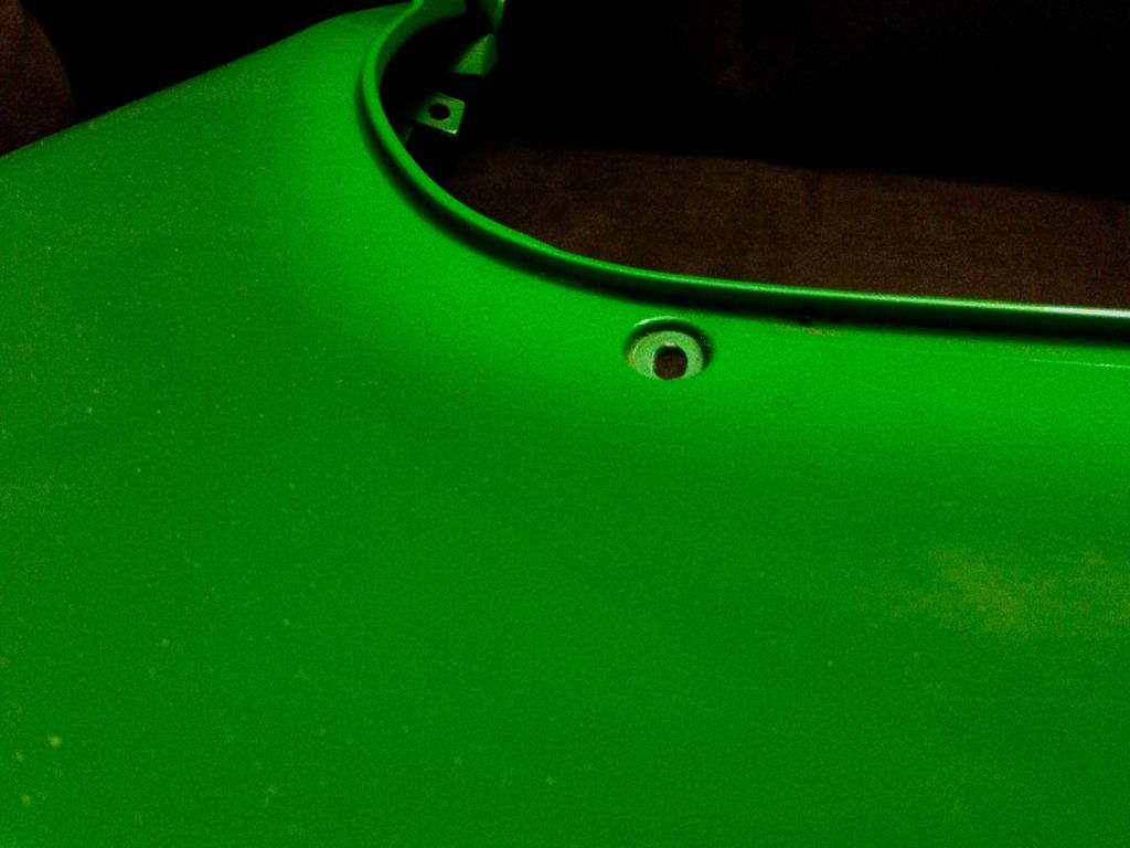

New plastics installed! Will get some nicer photos (with before and after comparison) when I have the time and get some decals on.
Paint does look really good, and it's a damn good match.
Only thing I see that might cause an issue is that it looks like you left some of the well nuts in the plastics when you painted and just painted over them? You might run into an issue with the well nuts moving around a bit(they are rubber so they do move) and the paint cracking in those areas and then progressing
I can't really tell if they are the well nuts or if those holes are different for a push rivet instead of a bolt. Hard to tell from the photos
