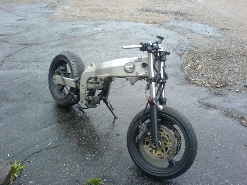

I have done a lot to my bike this winther.. the picture will show all:
The bike I started with was an Red and Black ZX6R 1998.
It was striped all down to 1000 pieces..
Then the engine was taken out ;)
so we have to take of more parts ;)
Remove all bolts and nuts
Put it all inn a box and blow over it with fine glass to remove old paint and dirt
Wash and refresh all old parts:
All roller bearing was fitted wit new one. thiss is the upper-bearing for the stearing:

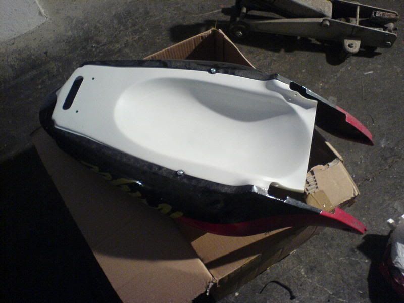

When all parts was send away for paint I adjust my undertray for better fitting:
Painted parts: Now it was time to rebuilt the cyckle:

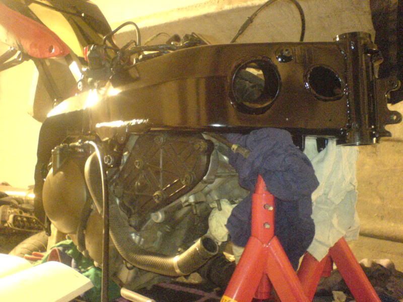

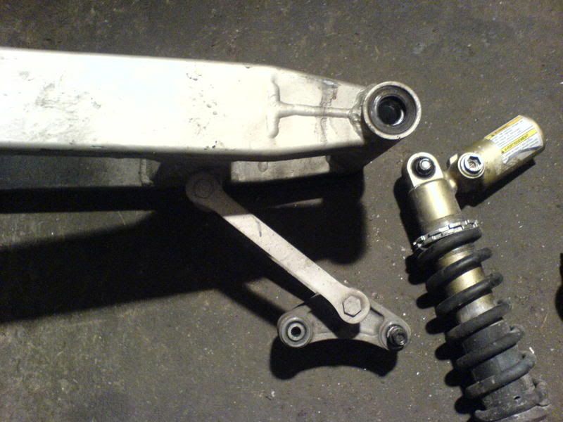

New bearings was pressed into the link-arm
New Golden chain and sprocket:
The link monted on the bike:

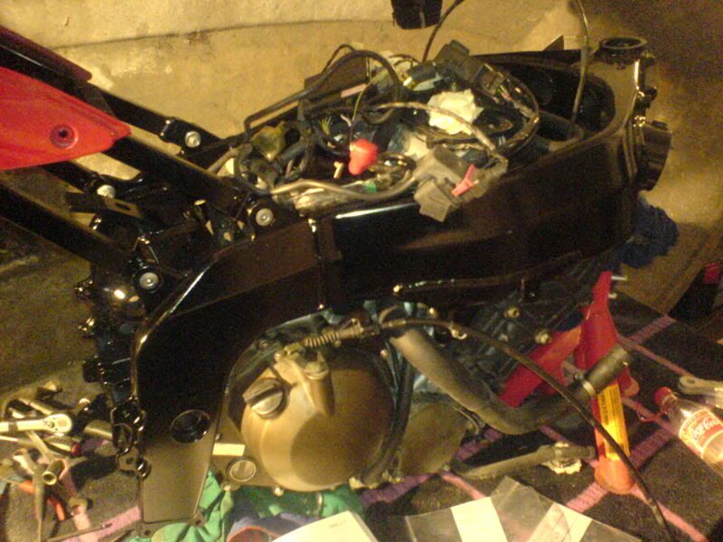

Started to put the electrics at the right places:

The baklink is fitted (again) had to take it of because i dont really understand how its fitted.. its not corect with the book.

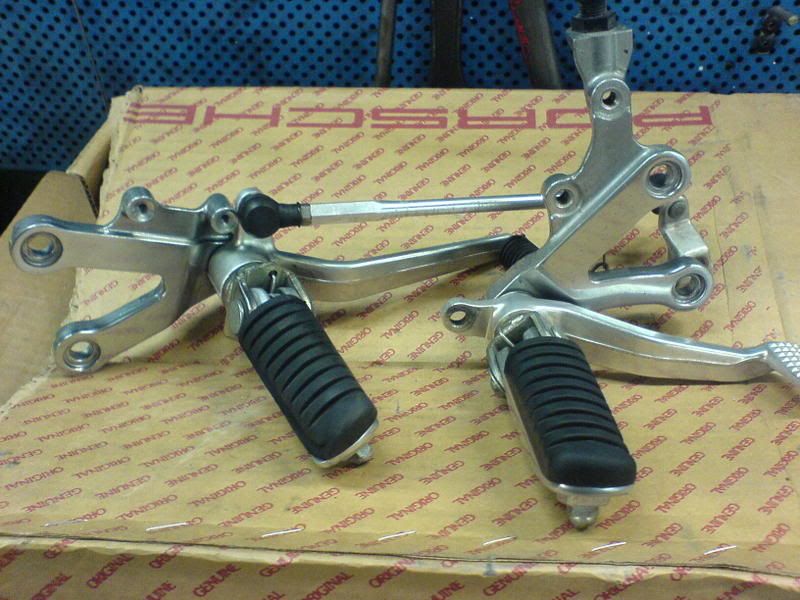

Pedals for the driver is fitted

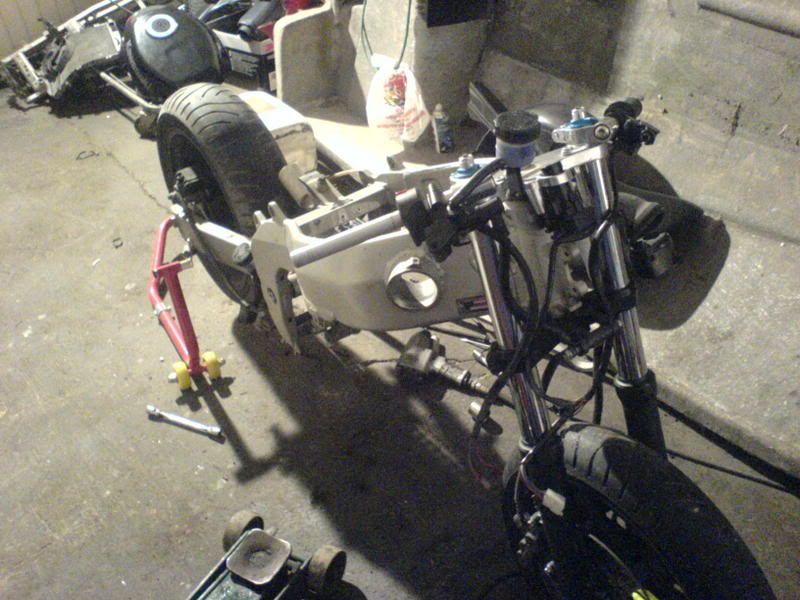

Test mont of carbo hugger:
yes..it defently need Golden calipers..
Lovely hugger :D
Licensplate on right place? heh.. no.. it's not gonna stay there.. ;) but maaaaaaaaybe..
I have also delivered my wheels for Tyre change.. get them back tommorow i think.. so the bike will soon stay on it own wheels...
