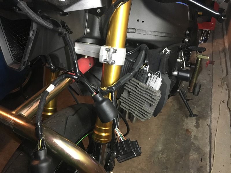

This weekend I got into the garage; forks pulled and off to get KTech cartridges installed
Hopefully next weekend it will be much warmer and I can begin to address this atrocity; relocating the rectifier under the tail and simplifying the harness like I did on my '05
