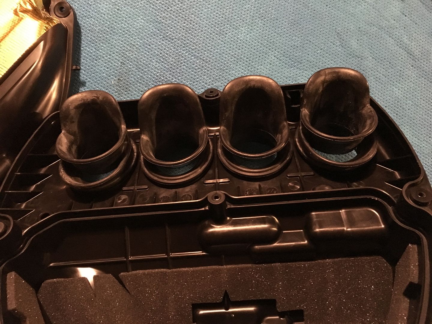

After that I took care of the intake side of things, installing block off plates
Swapped out my velocity stacks for 09+
Then on to the air box in my usual fashion if you know me I love race farkle so I wrapped the box in DEI Gold Heat Delfect because if you cant go fast you gotta look cool :)
Dropped in a BMC Race filter
And that wrapped up the intake side of things

Why did you change your '15 intake funnels for ones from a '09. Is it '09-'12, or just '09? I am running the BMC & Ivan's block off plates; and the Skutrnet Servo Buddy, as well.
Thanks in advance.
154 Posts
Discussion Starter · #13 ·
Thanks in advance.
My understanding is by changing the airflow it alters the power delivery to better in the higher RPMs.
