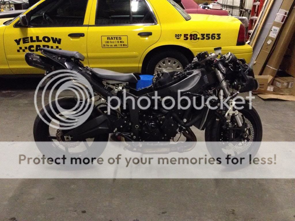

So for about a month or so I let it sit..both out of frustration and fear of finding more things that would just make me want to can it. I brought her down to her bare bones, and have fixed the fairing damage via welding using a basic $20 soldering iron at homedepot, drumel for guiding the iron, bondo/hardener for the small low spots and smooth finish, sand 80/150/600 to smooth everything out. Now I went a little unconventional on the next steps :devious and I will post pics and tell you why/what once I have it all back together. Below you will see her looking very naked (shes still sexy) with her tank off for repair. but all is well and is a work in progress.
Now with everything off I got to thinking..lets mod this sucker a little. So seeing as I have a stabilizer/two brothers full on there, I opted for some of the smaller revisions. On the docket is the rear brake res relocation, removing the plastic exhaust covering and modding the plastic cowling beneath the sheet, install 2009-11 rearset with 09-11 brake line, air filter change, new plugs, chain cleaning and more so please stay tuned as I will be updating when I can. Feel free to post any questions or comments, thanks for stopping in :cool3:

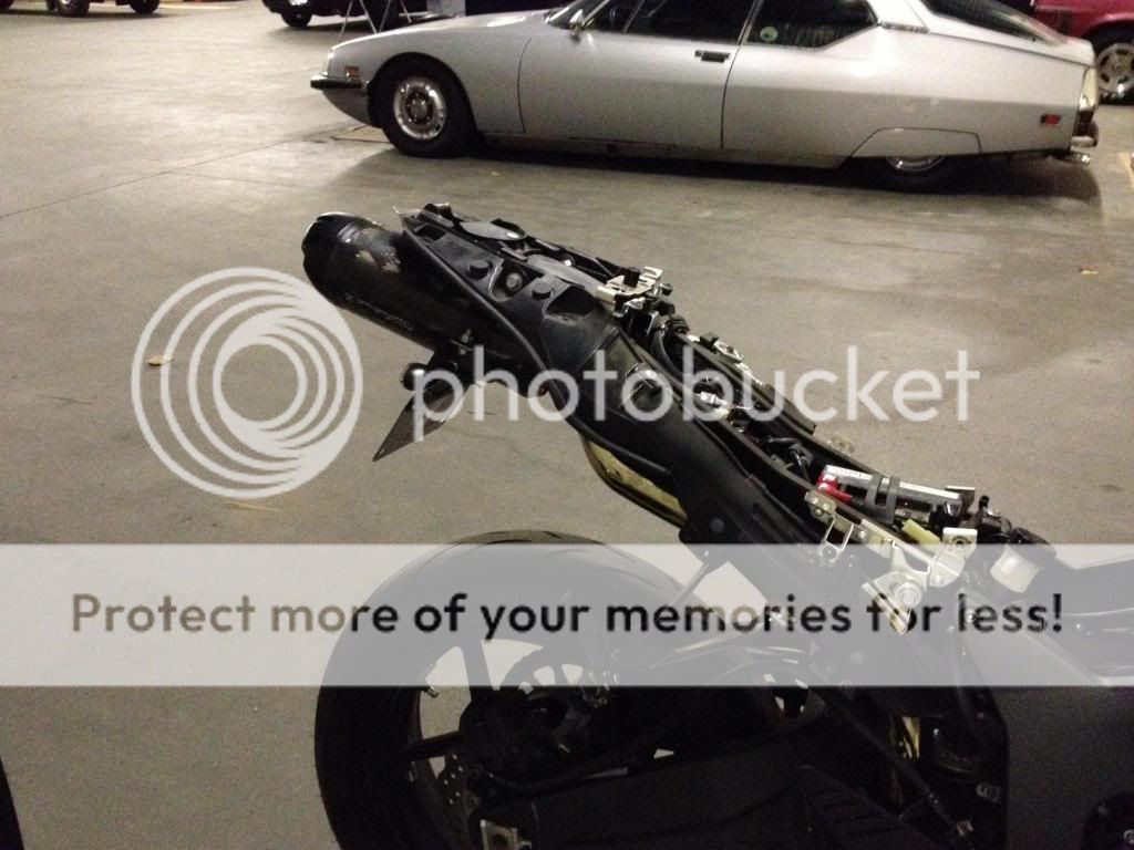

I removed all the plastic from the tail and trimmed the stuff under the seat completely, it looks 10x better than stock in my opinion. If you'd like to see if you want to do it or not I can post a few pics for you. I have the reservoir moved as well. Cool paint job you had there!

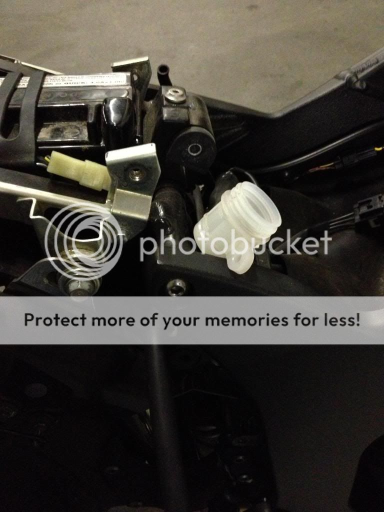

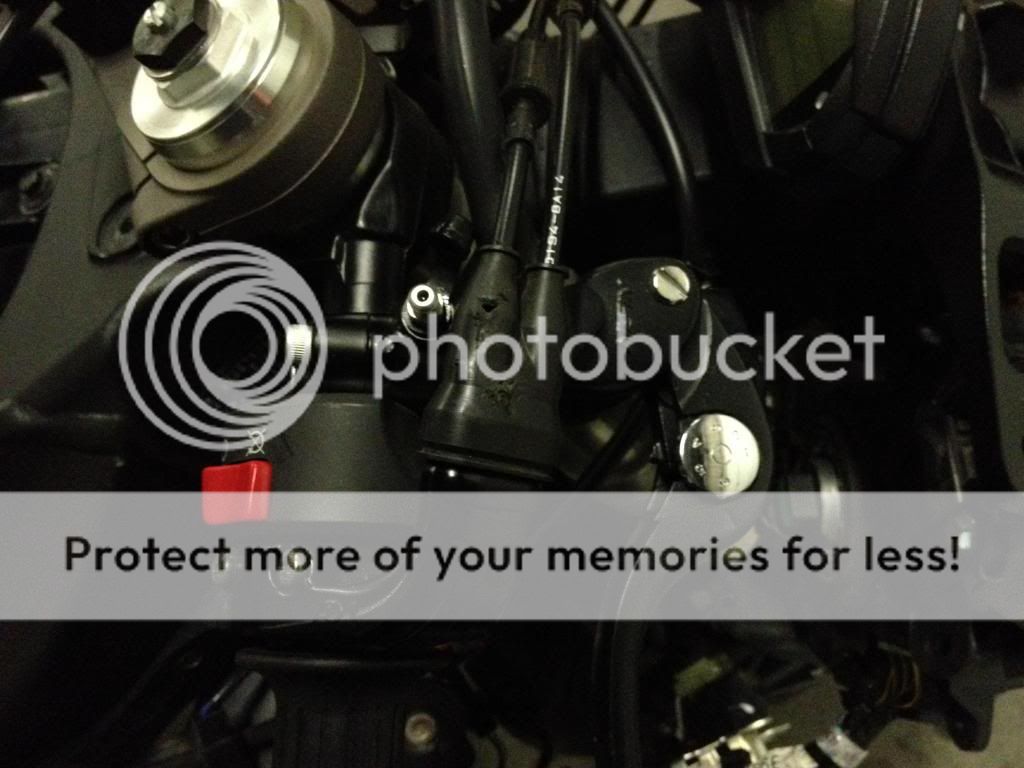

Does anyone know what the rubber gromet/cover piece that covers the throttle/brake cables right after the kill switch is called?

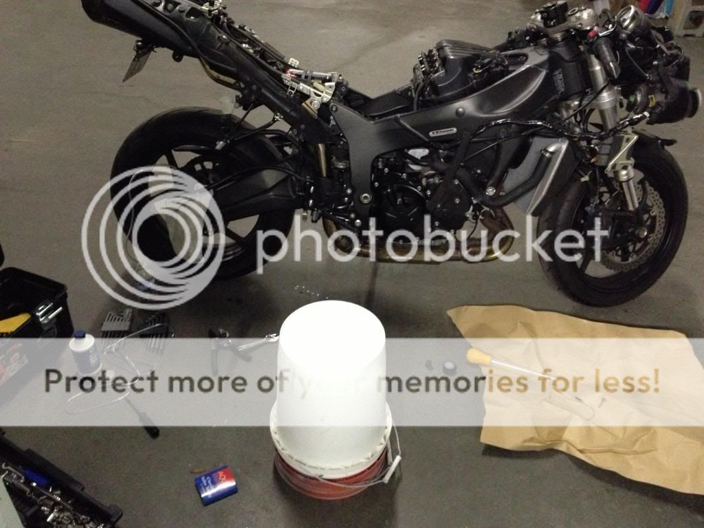

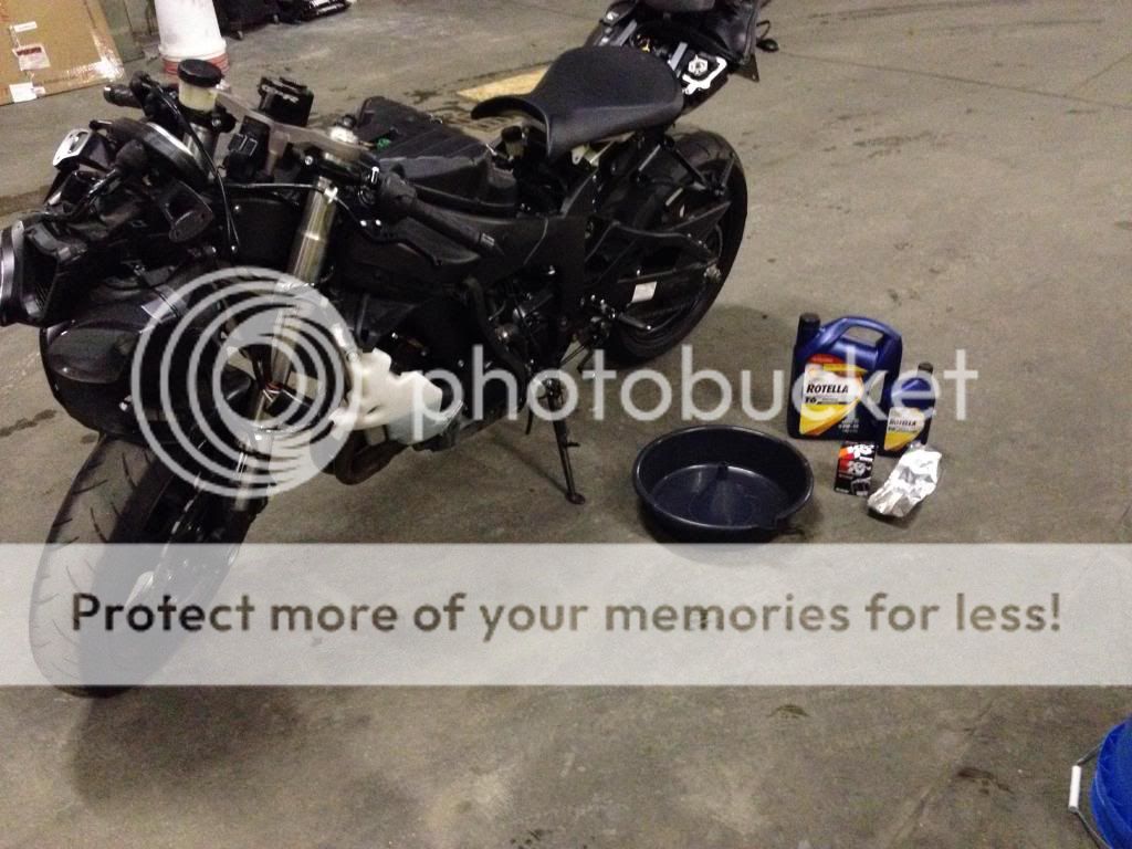

Been kinda busy lately, sorry for not updating guys.

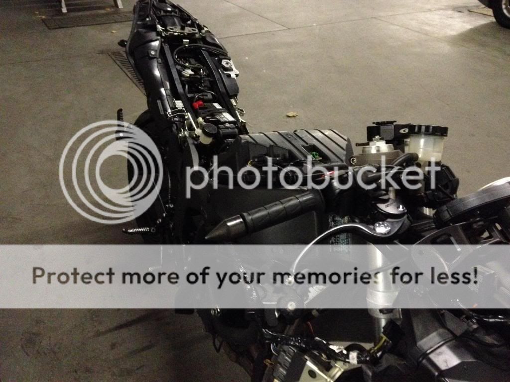

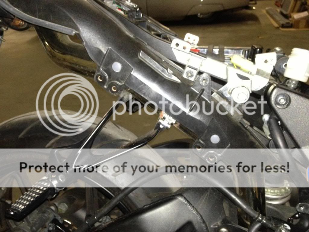

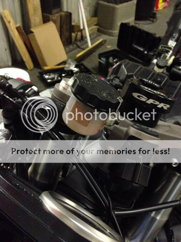

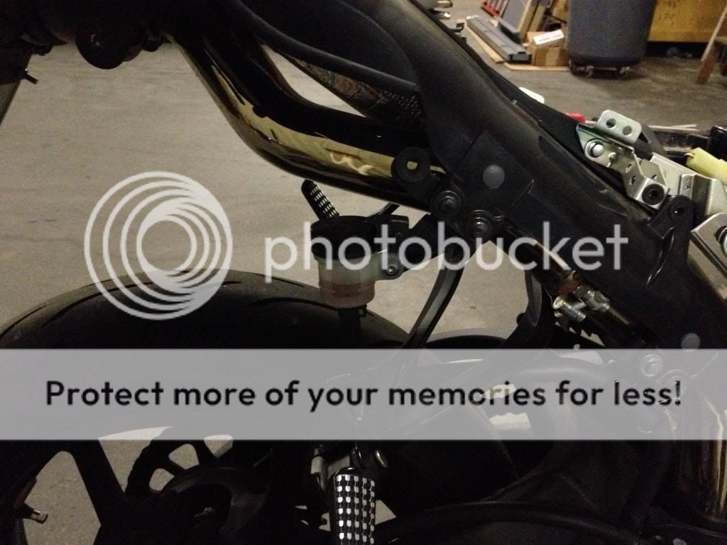

Today I did the brake reservoir relocation mod, tail plastic removal, installed an 09 rearset and replaced the brake fluid both front and back.

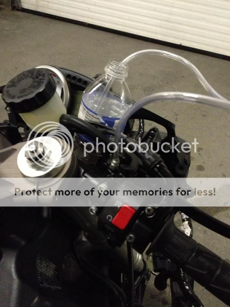

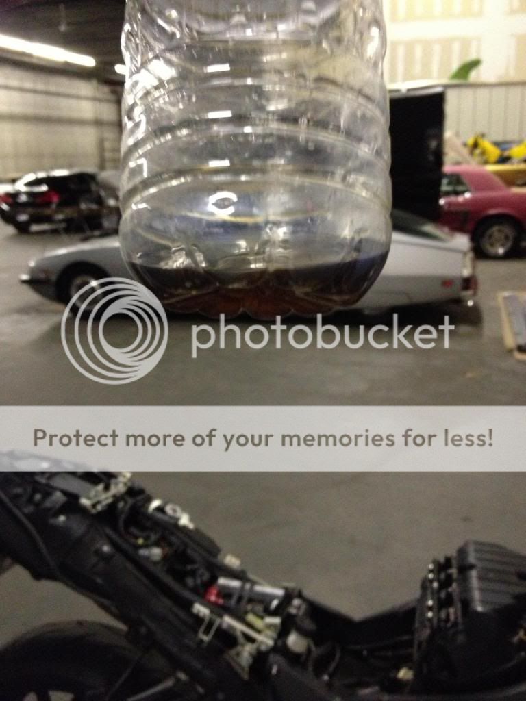

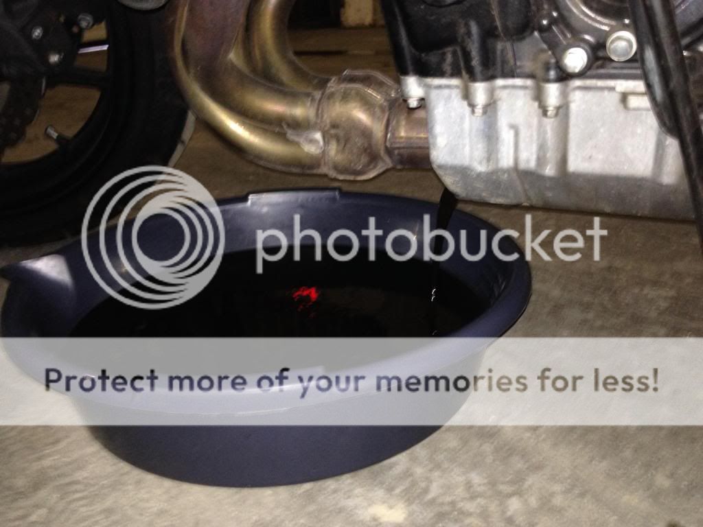

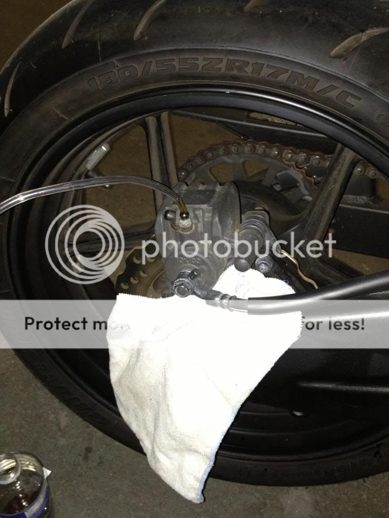

Brake fluid is straight nasty in this b*tch so I am going to drain that first. Used a turkey baster to remove what was in the reservoir, connected the tubing I got from walmart for $2 and proceeded to drain what was left in the system.

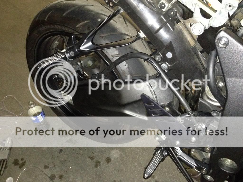

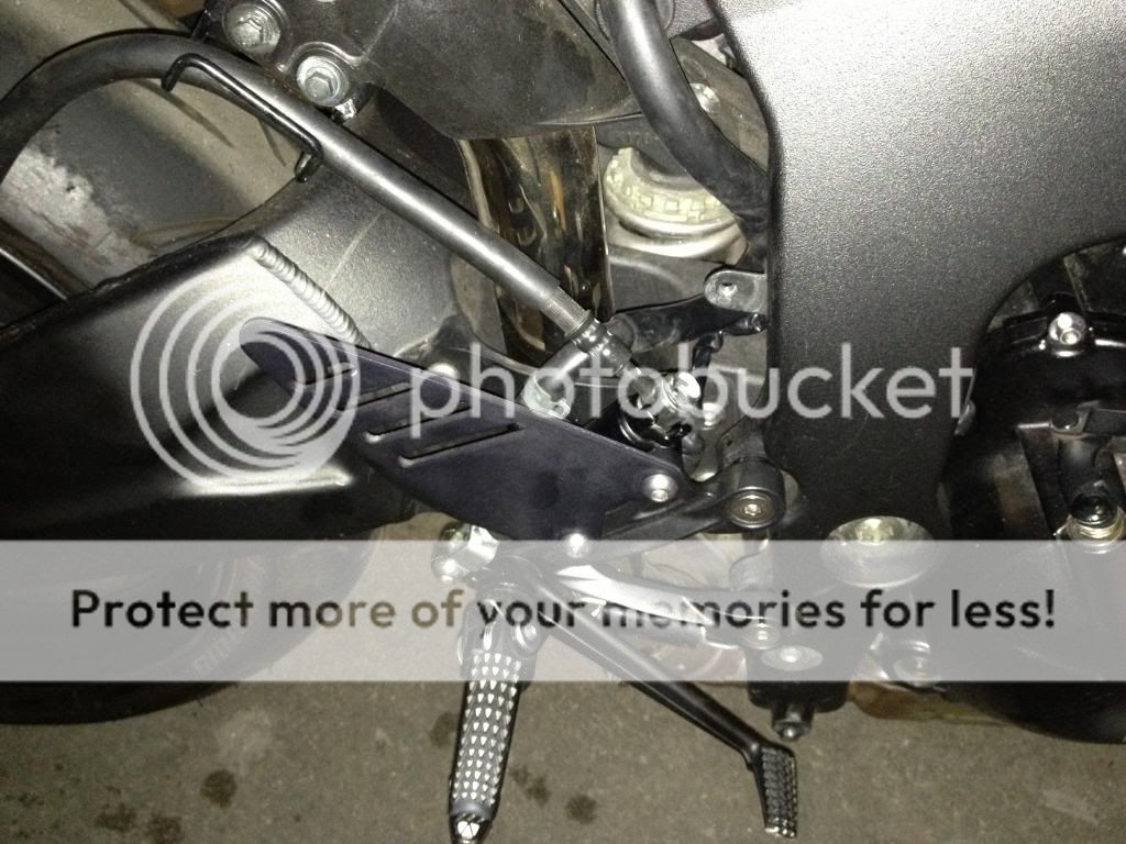

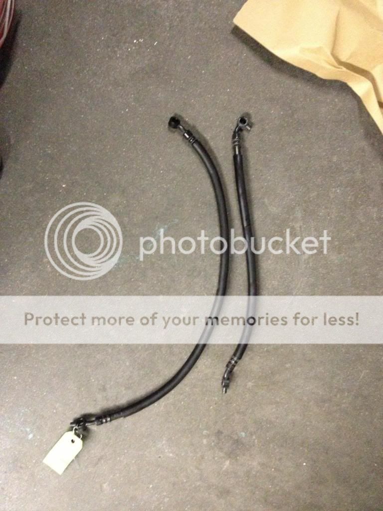

Once she was done draining her juices, I removed the stock brake line from the mastercylinder to the rear caliper. I did this because it was too short to allow for my 09 rearset modification and needed to go so off she went.

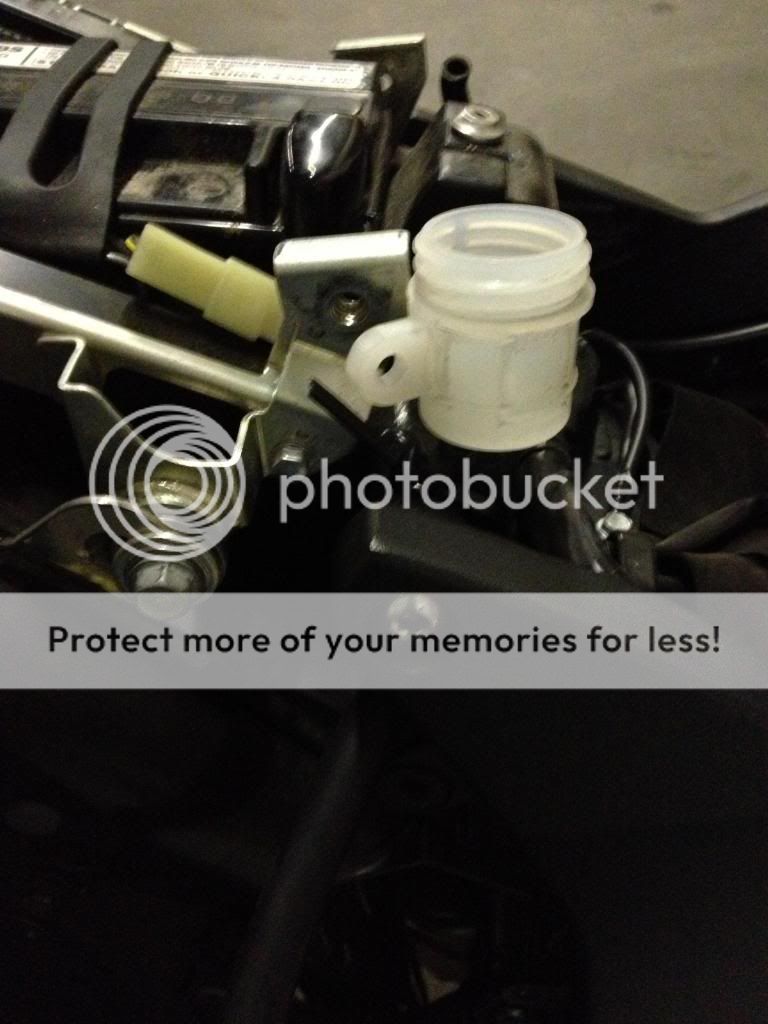

As you can see..the one with the tag is off a 2010 zx6r and the other is the stock that came with my model. Considerable difference. Once that was off, I moved to the rear res relocation. Used two zip ties and removed quite a good chunk of misc hardware.
Next was onto attaching it to the 2009 rearset and having everything work. The master cylinder is at an angle on the new models so the rearset is setup for this. What does that mean for me? A: Either purchase aftermarket 09-12 SS brake lines, B: Purchase an extended-swingarm line and have it look retarded or C: find a cheap used factory line and see if it fits. I went with C and it fits with literally maybe 1/4 of an inch of wiggle room. Used same banjo bolts and crush washers as they werent worn in the least. Everything fit spot on, only difference is stock line had tabs on the ends of the rings and the newer one didn't. Now you may notice I re-installed the holder for the brake line, this is because without it it comes pretty close to the shock/where the swingarm pivots/exhaust pipe and I'd rather not take chances of something melting/crimping/not being able to use my brakes. If I go the SS route maybe I'll take it off completely, but for now I'm fine.

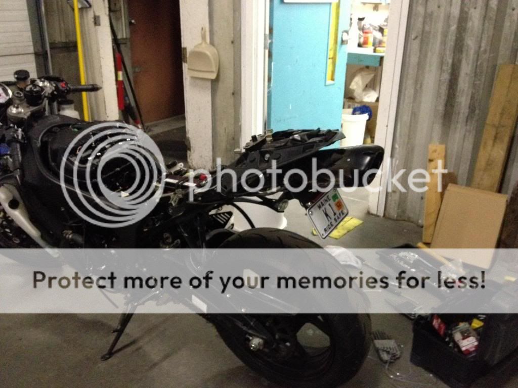

Once that was conquered, next was on to thin-out the tain section. There are only 4 hex bolts holding the plastic coverings between the tail fairing and exhaust so those had to go. Be mindful out of the 4 total bolts, the one on the right-hand bottom was a pain in the arse because it has a small nut thats hard to get to holding the bracket. I'd recommend someone with small hands help you with this or use a monkey wrench like I did. Even without the fairings on I'm a fan.
At this point I'm ready to re-install the brake fluid. Now I drained the rear and the front, I just didn't photograph the front as theres multiple videos out there on how to do this.
For the rear, fill the res with fluid. Chances are unless you did something wrong it will drain itself within a few seconds after you've drained the system. Once this happens, I refilled and began the pump/nip action. For those unfamiliar, pump the right pedal a few times and *while lever is down* release the nipple and let old fluid and bubbles leave the system. In order for the second round of pressure to build, you must close the nipple before releasing the lever. I ended up filling the res 3 times total before the system was bled, came out clear and stopped the bike when rolling forward with ease.
The front had me upset for a little bit, not gonna lie. After draining the calipers on both sides and the res, I closed the nipples and filled the res once. Pumped the front brakes and it didn't give much response so I repeated this for about 15 minutes and nothing was happening. After rebleading the system twice (completely unnecessary), I did some looking around and low and behold there is another bleeding nip on the right bar. Had I noticed this..a 1.5 hour frustration fest couldve been 15-20 max job with limited tools. It is in an awkward place and caught me be surprise but by bleeding it after the calipers were done (hold lever, release nip, close nip, release lever and pump 3-10 times) the brakes returned with marked improvement.
Clean, clear and under control. The brakes on your bike should work without it being on. If they do not, check your lines for leaks, missing washers or nips to see if ones possibly open.
So changing your brake fluid and brake lines isn't difficult. The relocation mod will help shield the bottom res from the light and also gave me the necessary room to install a different rearset.
Thoughts on the rearset..originally I was trying to save a few bucks as the only rearsets on I could find were between a hundo and 125. Got this rearset for $65 shipped (after some negotiation), spent $5 on fluid, and $17 for a used brake line so the savings wasn't humongous but I gained the experience which means more to me. I have tried and now can prove rearsets for ninjas 05-2012 are the same bolt pattern on the bracket, the master cylinder however maybe positioned differently requiring slight modifications like above. This would not have worked without the relocation mod.
To give you guys a teaser, its about 90% finished. Ill post more pics once I get the tank back from the body shop and have everything clear coated and assembled.
PS Even after searching bikebandit I can't locate the part number of this rubber fitting..anyone care to chime in? It seems to cover the throttle cables, maybe for keeping water out?

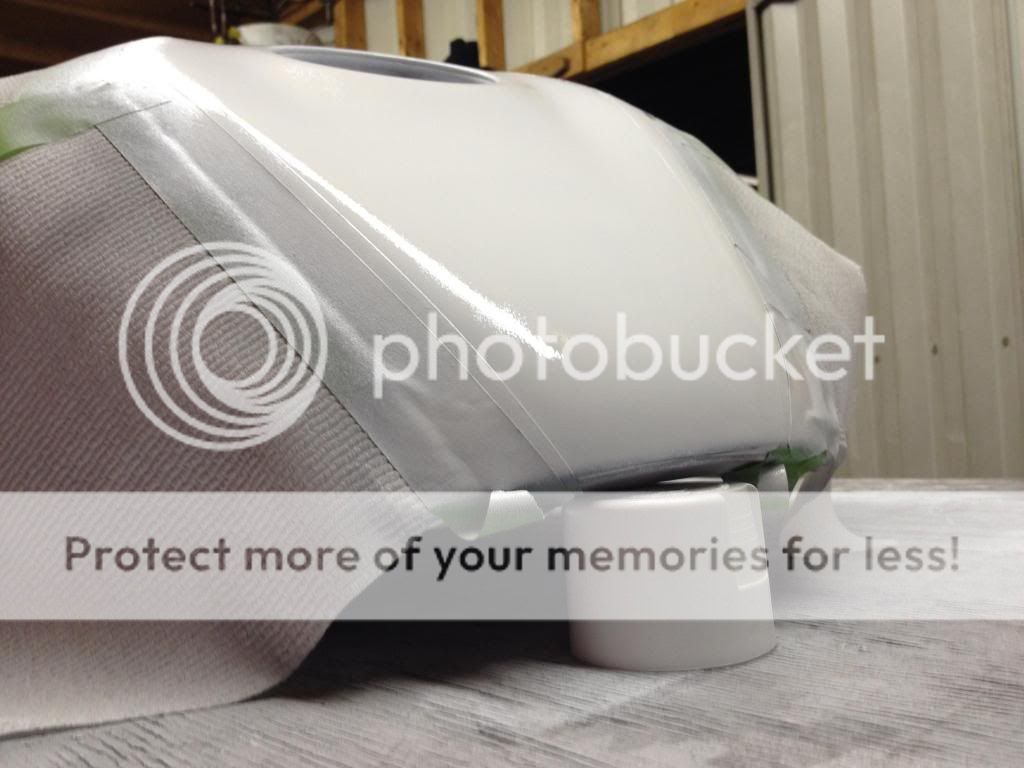

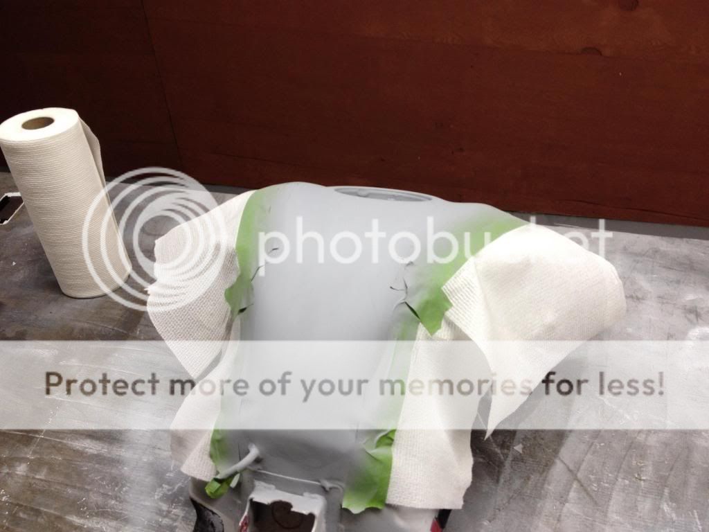

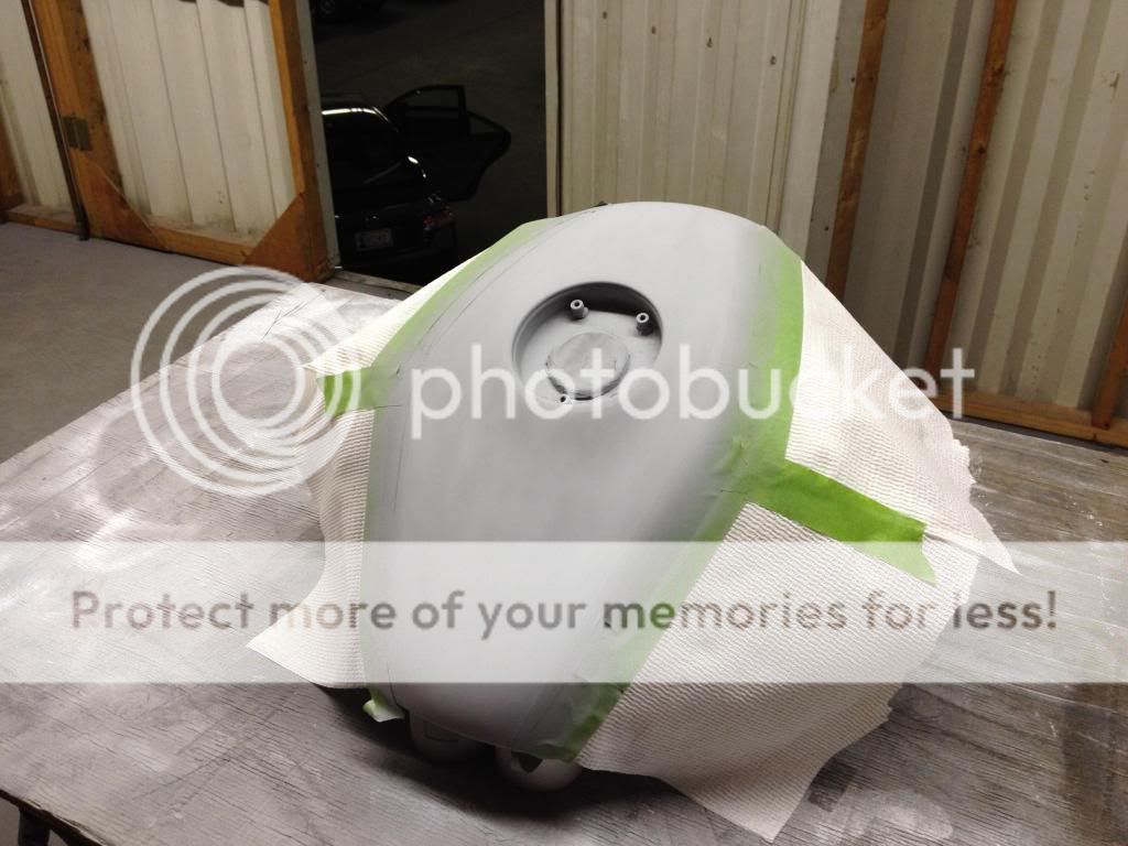

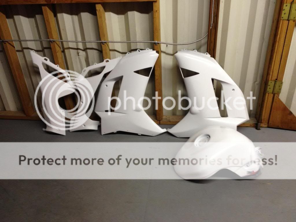

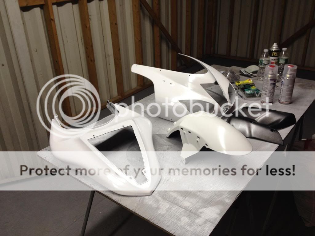

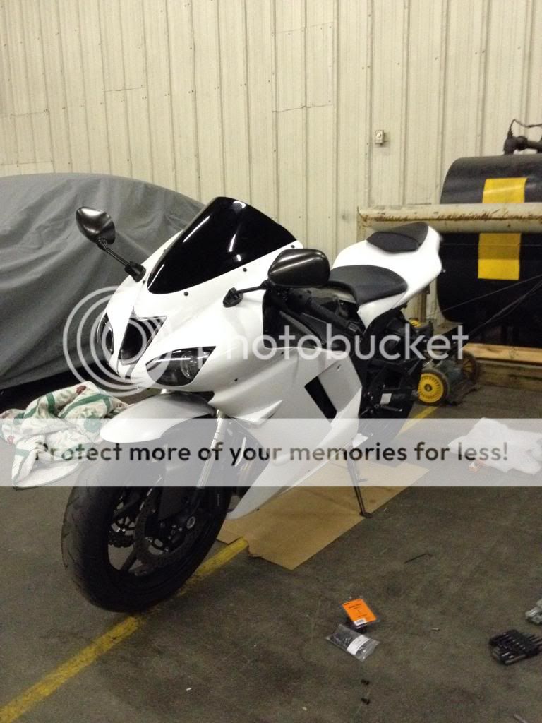

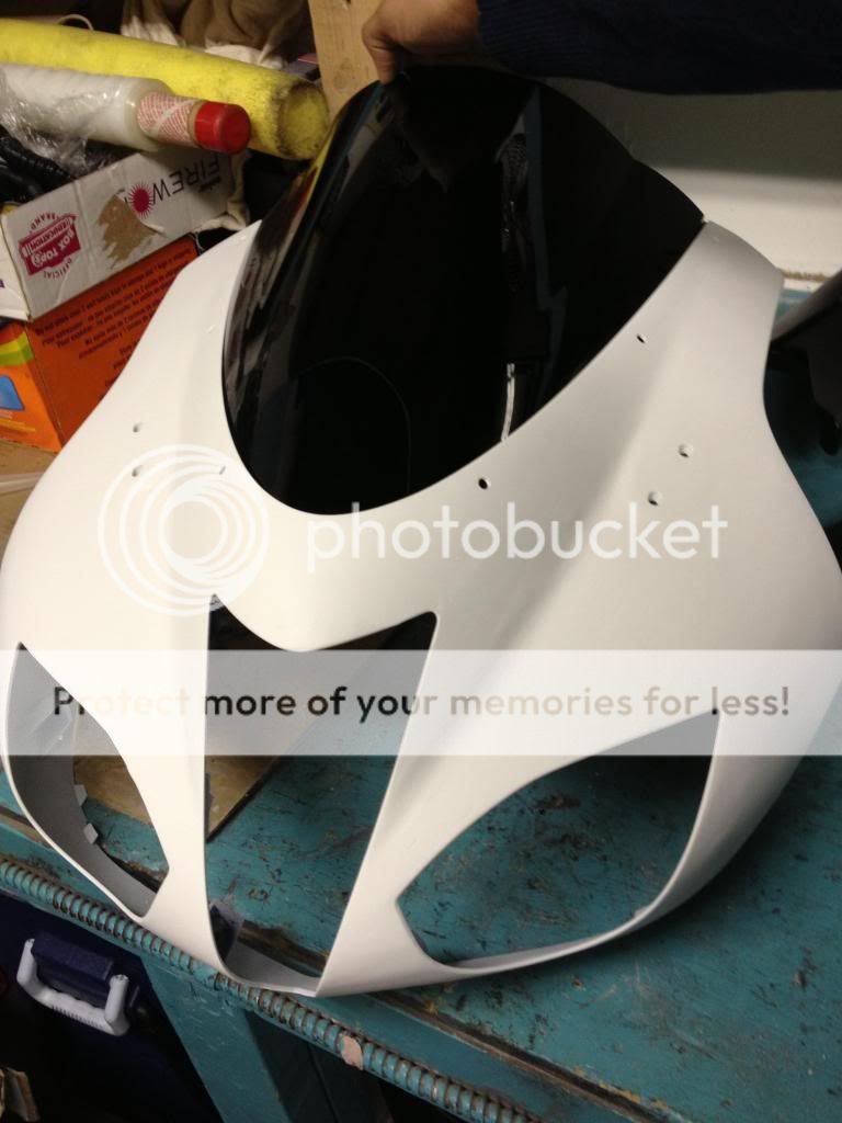

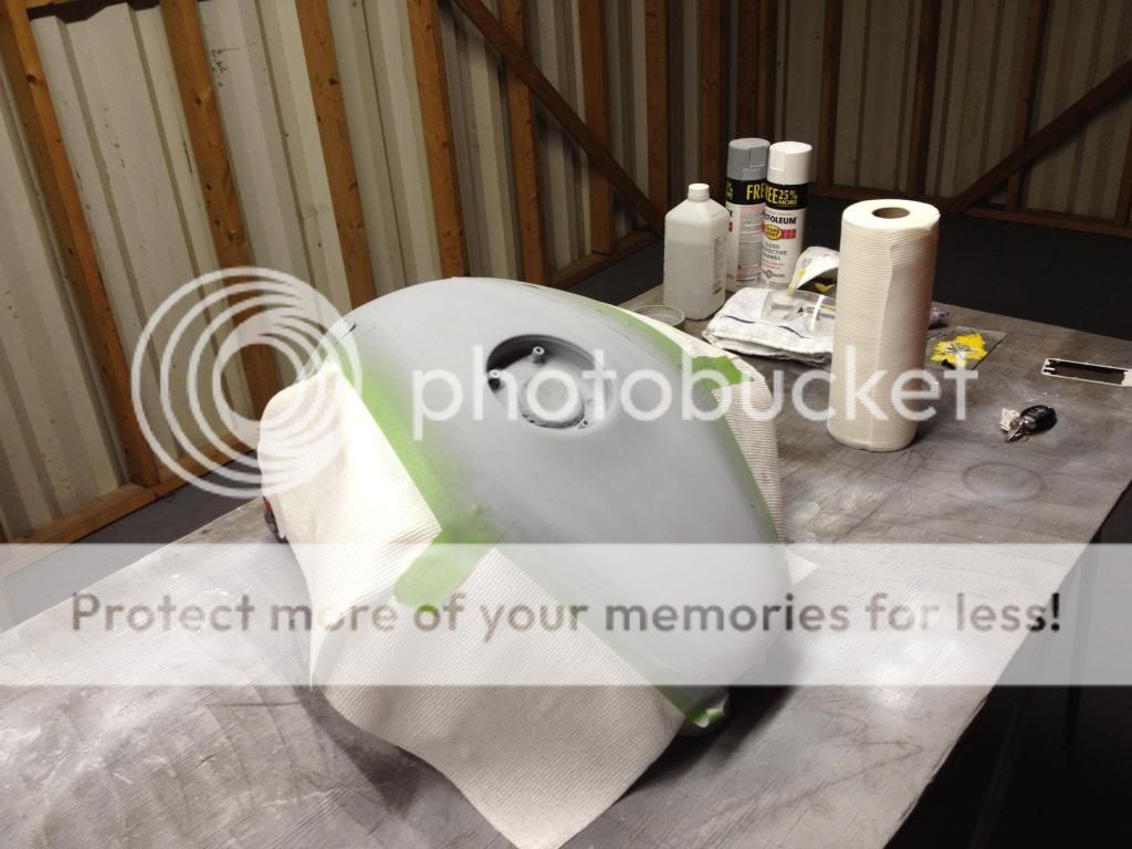

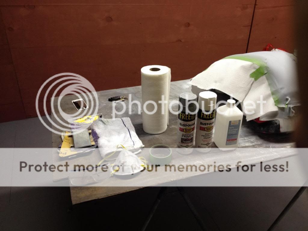

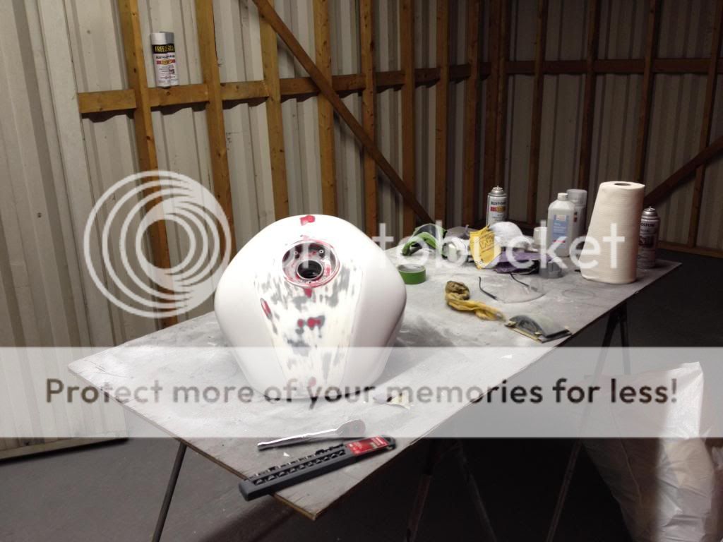

Whats going on guys. I have survived the drastic cold here (0 deg, -25 with windchill) and I have been putting some time in on the bike. I have primed and painted using Rustoleum products. Auto primer and high-gloss white enamel. Sanded all with 80 grit, 150 grit, 600 grit before priming then used some alcohol 70% and a microfiber towel to remove debris. After that used the orange 'final' cloth to remove any remaining residue and primed 2-3 coats on each piece and gave it two solid coats of the high-gloss white.
Painted the entire tank, then in my efforts to determine a starting problem I got gas on it so shes on the table prepped and primed at the moment. Below pic is right before I taped it and primed it. I'll take more pics tomorrow of it primed.

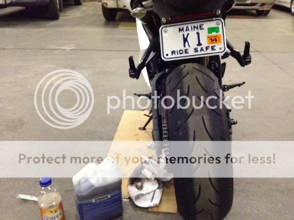

When I cleaned the chain (Kerosene and k1 :p). Didn't get a rearstand, so I was wheeling it around the garage but the job got done. They only had the gallon of it but if you can get it in a pressurized can.

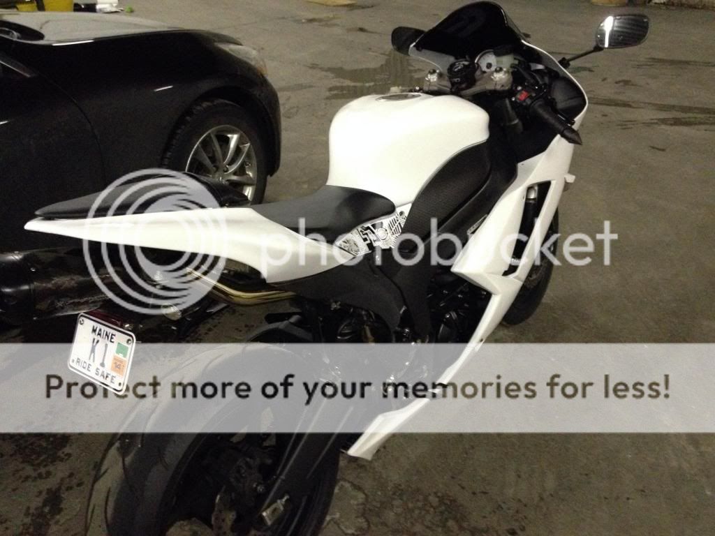

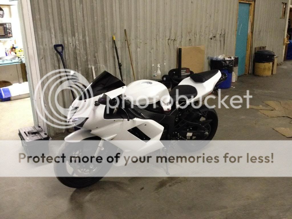

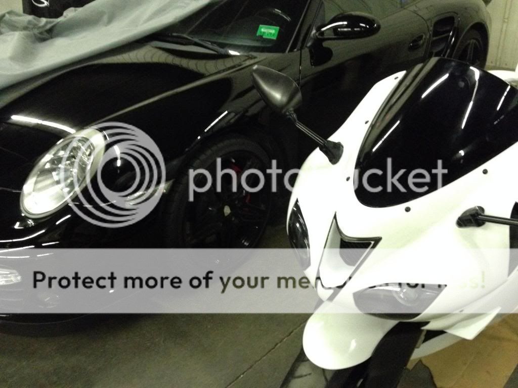

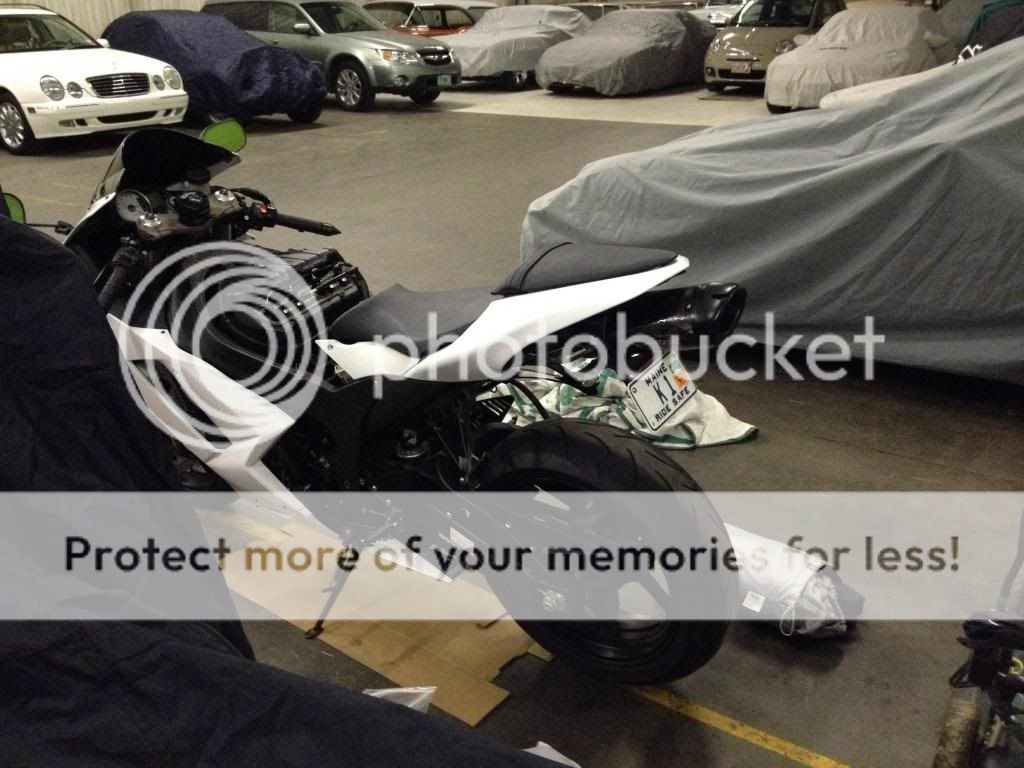

2/3 Put together. I've had a few people say it looks like a storm trooper..really dude? I plan on doing a graffiti sharpie custom style on the bike. I will start with the nose, move to the sides and possibly the tank and rear we will see how it goes. I've got my sharpies and I plan on covering that with SprayMax 2k spray urethane clear coat. I always thought the front turn signals were large and not attractive so I covered them at an angle with painters tape and applied a few coats of white. I like how it turned out.
In Maine, this is how some go about things. Took this pic outside my tint shop before I left what are your thoughts? :lol: PS this surely is not my car.

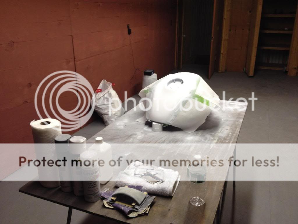

Heres some pics of the tank while primed and with color. Prep is key, don't let anyone tell you different.
For the most part, these are my painting/sanding products.

Looks like your torn rubber cover will be expensive as you'd have to buy the whole cable:
2007 Kawasaki NINJA ZX-6R (ZX600P7F) Cables | MRCycles
How about flipping it over ?
Nice plastic repair BTW.
I ride an 07
I'll give it a shot..not worth the whole cable. Thanks man, what color is yours?

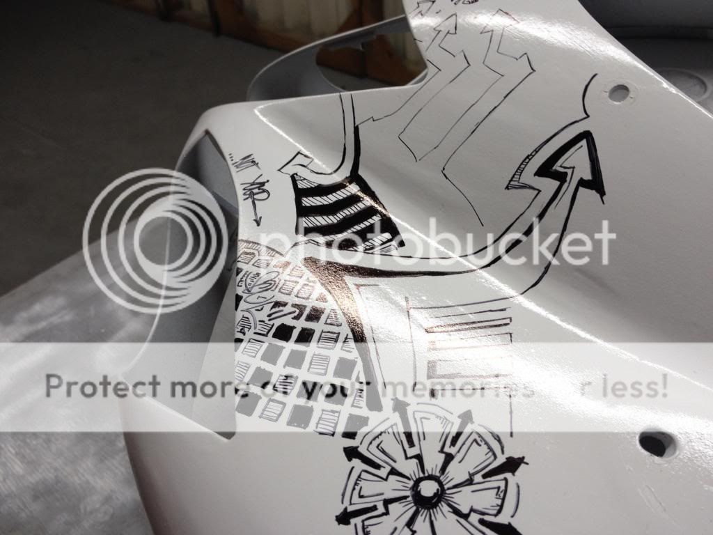

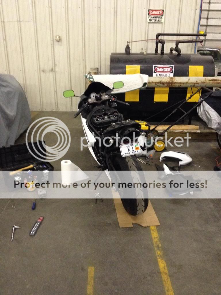

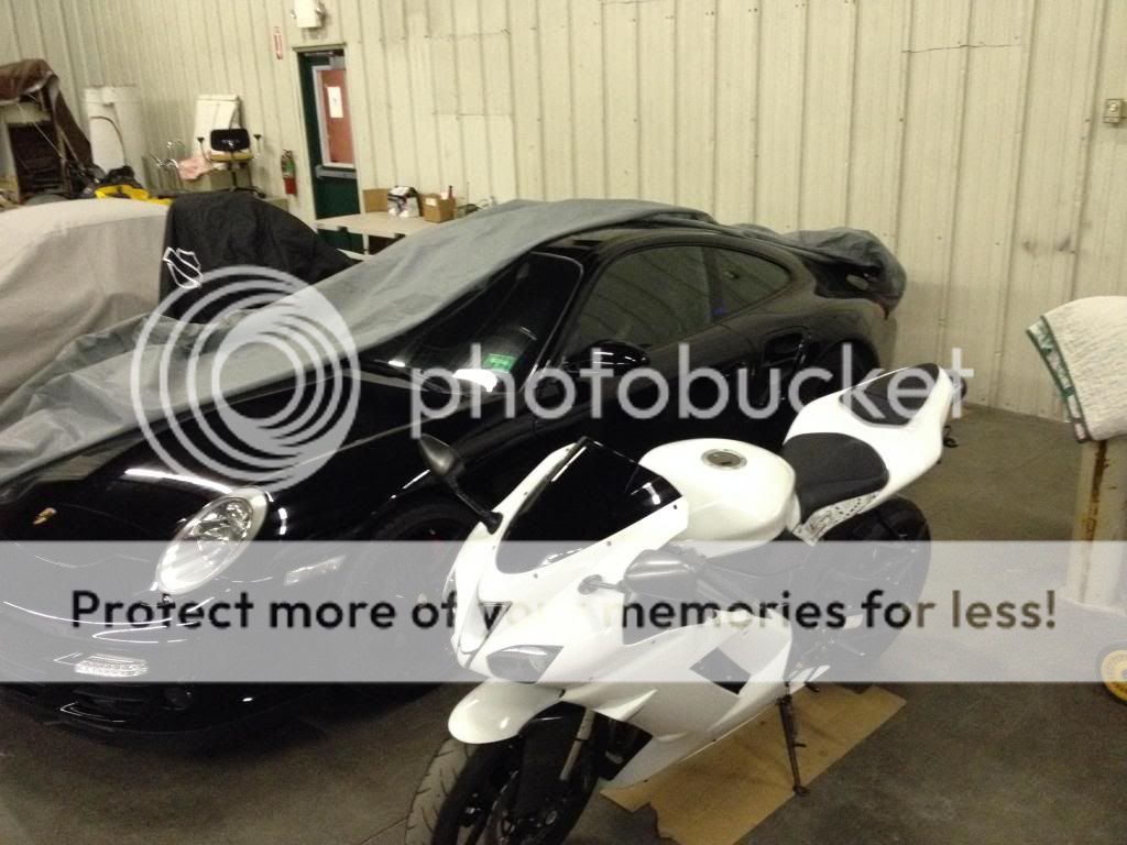

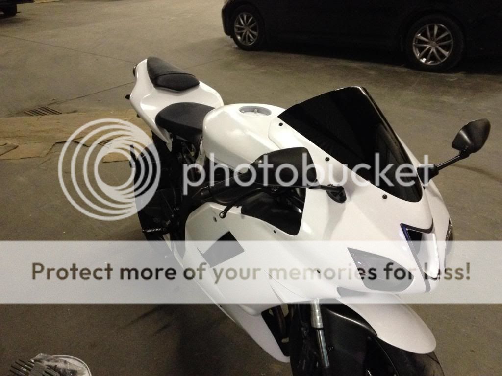

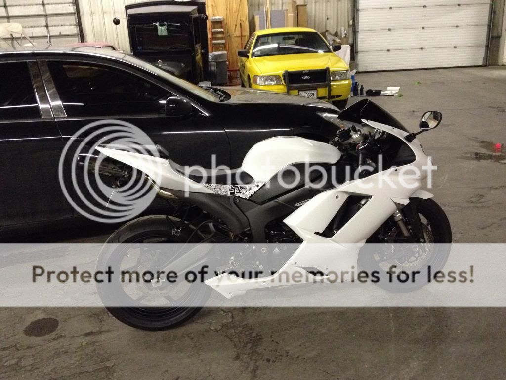

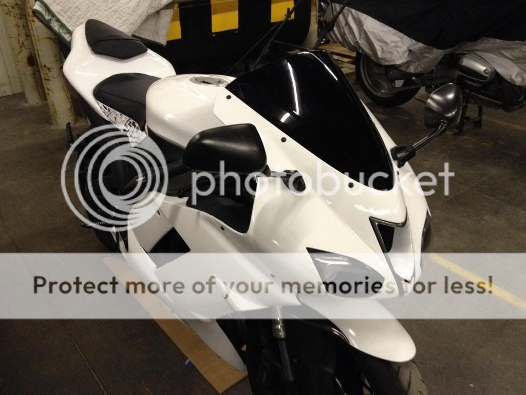

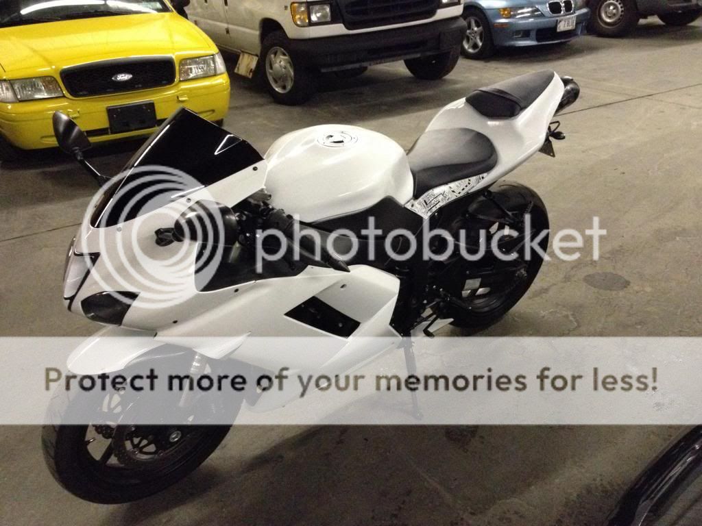

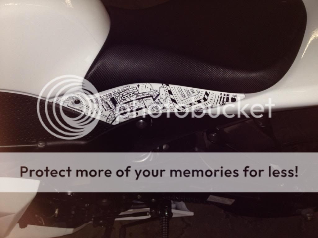

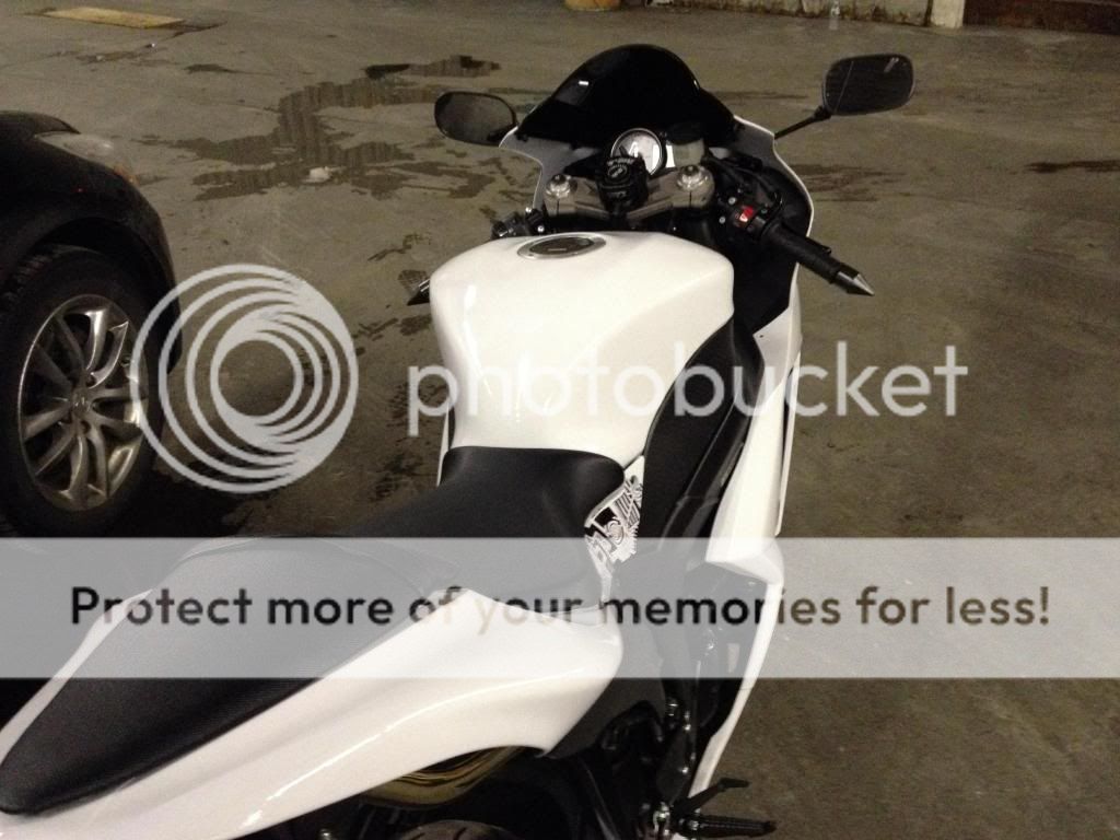

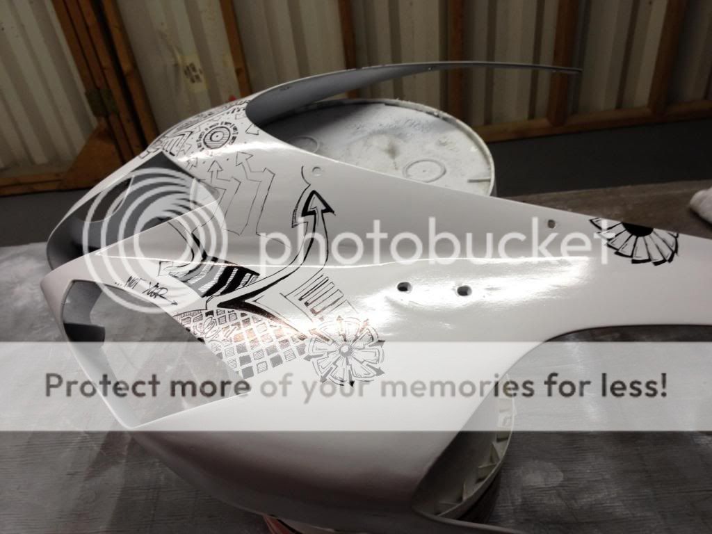

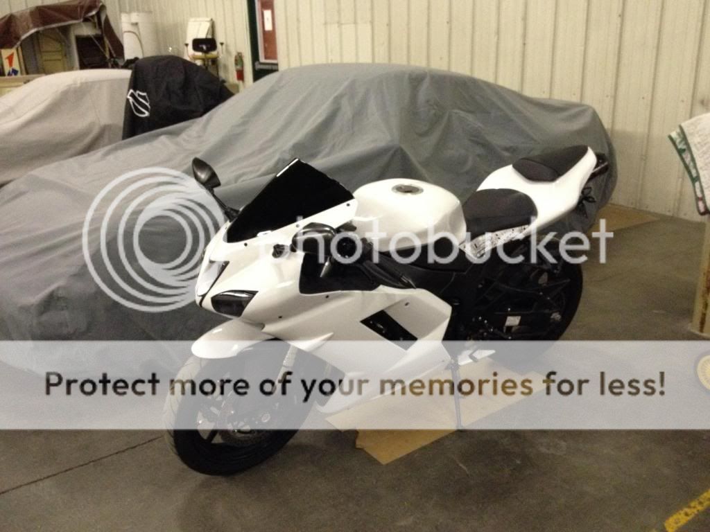

Small Update. I've started the graffiti project. The bike is all white right now just figured I'd post it up.
