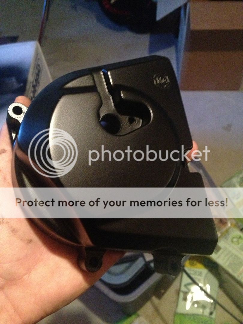

This is just an example of how dirty my baby is from its previous owner :(
OND would be so upset lol

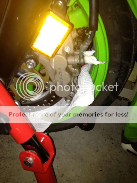

Todays project? Install Hel SS Lines and Speed Bleeders. (whenever they come in the mail today)

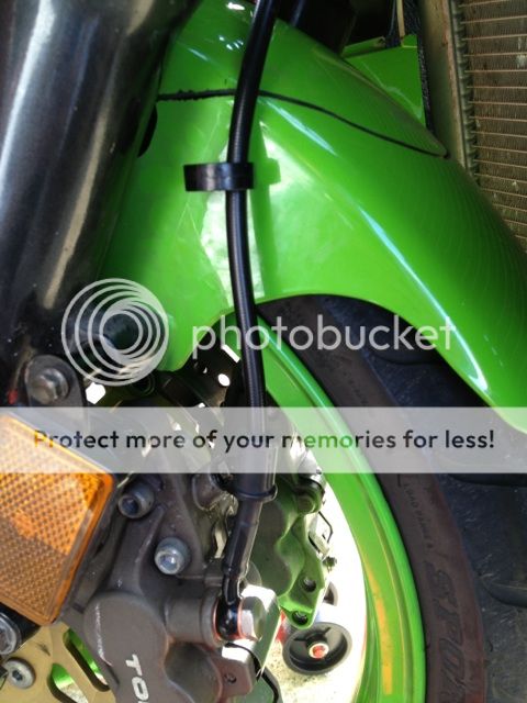

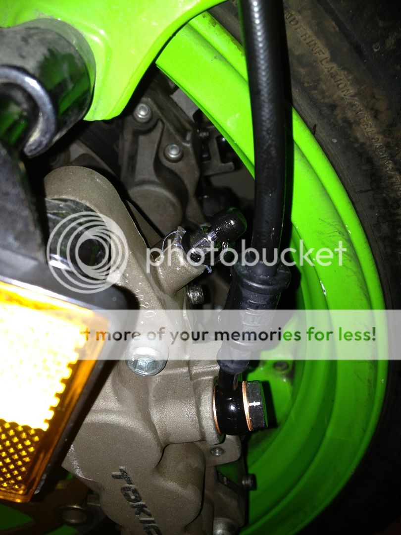

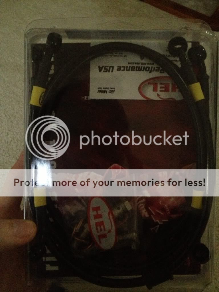

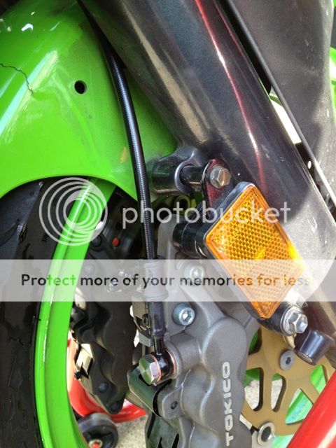

My lines and bleeders are in!
Black SS lines from Hel and speed bleeders order from my neighbors at sport bike track gear.
