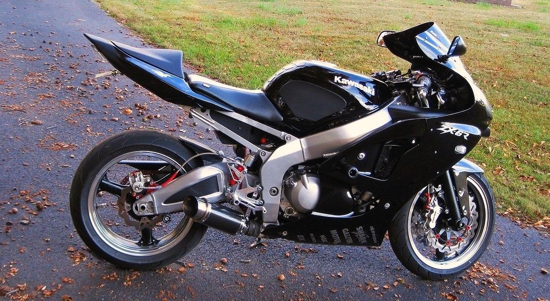

Face lifted....
The only mod you can't do to a J, is the one you can't think of ..or afford....
USD forks are next.
Wow that's a stunning bike! I like your way of thinking too.
