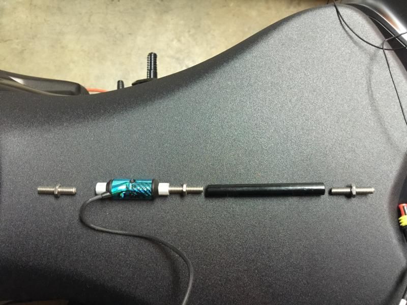

Step 1: How to pick the right shift rod to buy
- Measure your your stock shift rod and get the length in mm. Once you have that subtract 55mm from your stock length and the resulting measurement is what you need to order.
Ex: Stock shift rod(145mm) - QS Module(55mm) = New Shift rod(90mm)
Step 2: Install QS Module onto new shift rod

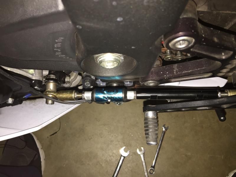

- Simply use the provided screws and nuts to attach the QS module to your shift rod. I have Attack Performance rearsets that uses a male shift rod which is why mine has the extra screws on both ends.
Step 3: Install shift rod onto bike
- This is pretty self explanatory, however I do want to note that you want to position the module in some sort of way that you can see the red led.
