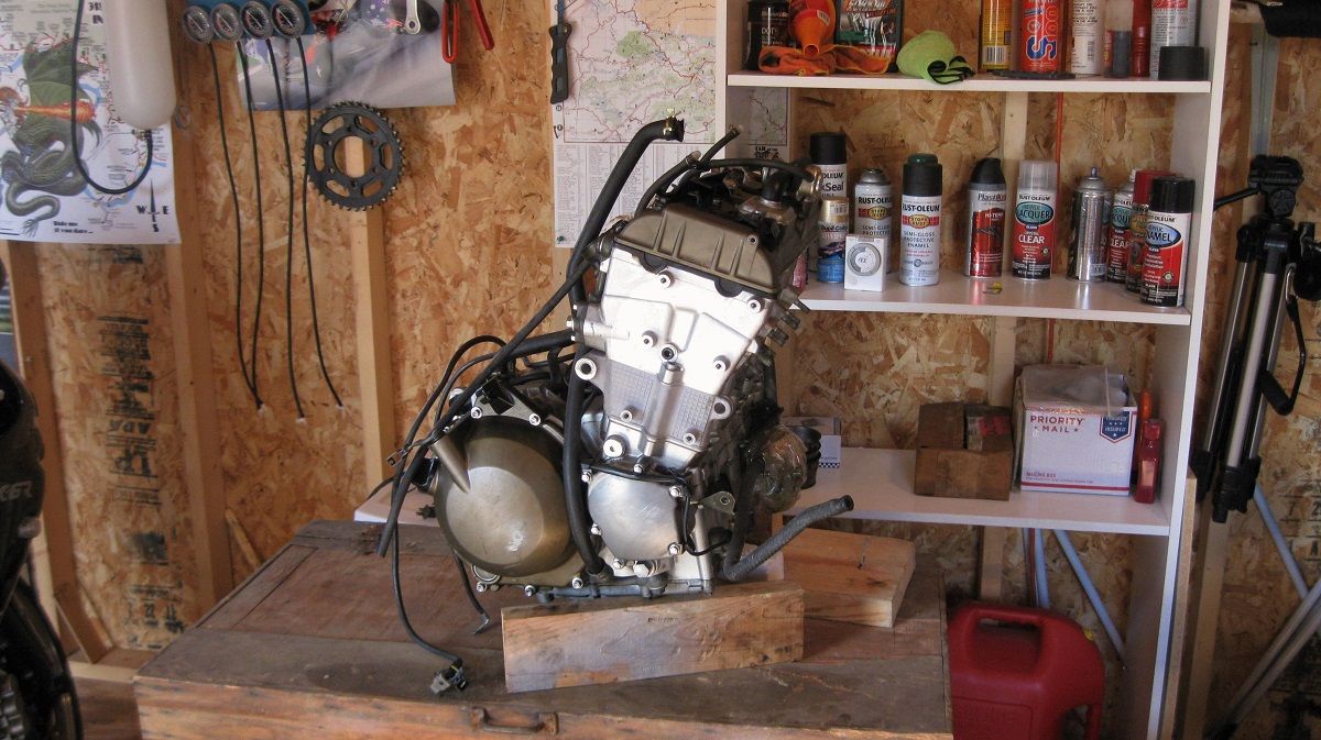

New used motor 17k to replace mine while I rebuild it.
After this I'm going to put USD forks on her..
Before we get started on this, I need to make it clear this is not a write-up, right now I'm just sharing.
A write-up "May" come later. But really there are members here way more qualified than I to do that.
Im just stumbling along for now. For now this thread is just for fun.
I intend to come back & at the least clean up any obvious mistakes. There will proly be a few...:sigh:

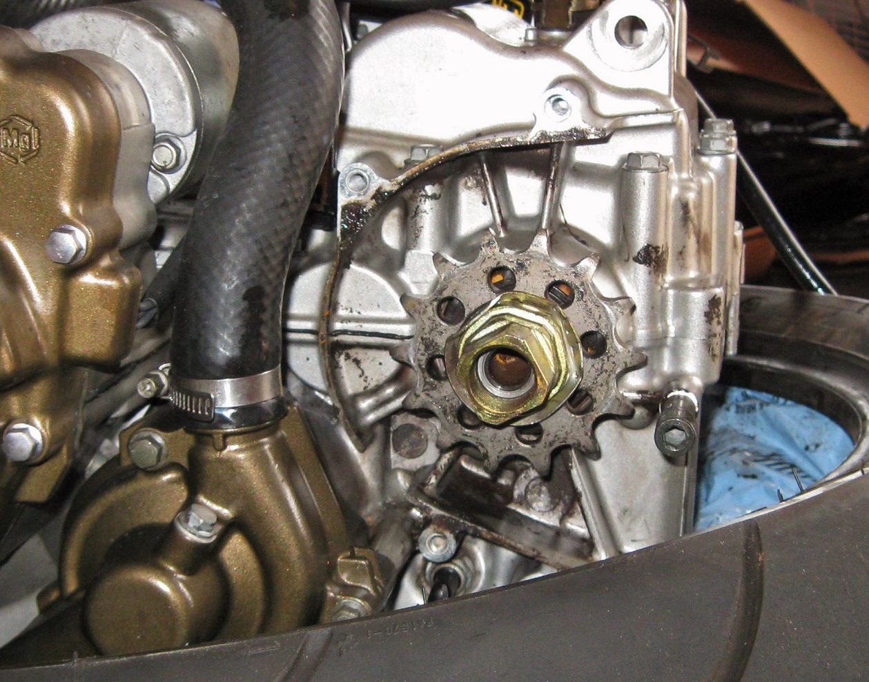

14t c/s...rpm difference just turned your 17k engine into a 20k engine.
But seriously, adjust the valves while it is out, much easier!
Then you still have all the cursory checks too.
Yep I seen that 14 tooth sprocket, I also noted its likely the only sprocket change this motor has had,
(look at the washer)
And from the look of the teeth, its not been on it for long.:)

sooo I got time to do a lil work, first was getting this 150 lbs lug off the floor.:cry:..
Next is to set 1 & 4 to TDC...
& check the valve clearance....

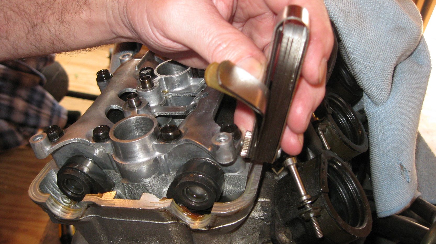

Heres a teaser pic....
as if I know what I'm doing...lol
Reactions: 4
I really hope that is just staged for the picture, because your cam lobes are facing the wrong way to be checking valve clearances there!
You know some idgit will look at that and think that is the proper way to do it and fuck up !!!!!!!!!
you should know better than come out and display the wrong information, misinformation !!!
Some asshole is likely to come along and slap you upside the head or beat you with a 2x4. And you would totally deserve it.
Change that picture to the one you send me in the PM........atleast that one has the cam lobes aiming the proper direction
haha you did see the bit at the bottom of the pic where I said .."As if I know what I'm doing"
LOL & who might be the asshole to come along & beat me with a 2x4???:sigh:
I think we know. LOL
riverszzr is right folks, the proper way is to insert the feeler from the lobe side.
This way...
Checking the clearances, This is what I got in hundredths of a mm....
