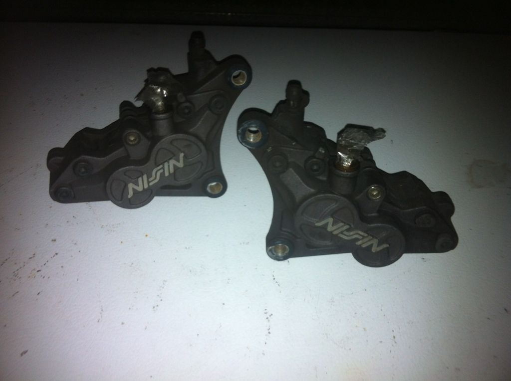

here are some pics of a couple of rebuilt nissin calipers from a 1200 bandit
they are a great upgrade to the zx6r J series tokico calipers
and bolt straight onto the j forks without any mods

the calipers are 90mm from centre to centre of the fixing bolt holes

right took some pics today of before with the old tokico calipers
and now with the nissin upgrade ....2 less pistons but they are bigger
as you can see the calipers are a direct fit
the only thing you will need to change is the banjo fitment
reason why......... the thread is different
now dont panic as calipers only use 2 threads .....metric course and fine
the tokicos use a course thread as you can see in my hand .....all you need to do is get a fine thread fitment ....which everyone stocks and are cheap
