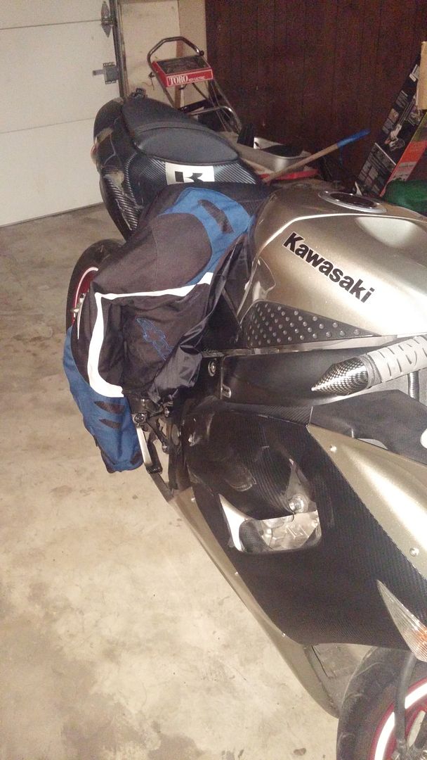

well the passenger one is just hanging there to. but i will probably just take em of now. am i still just able to buy the peg only?
A picture of the damage would make diagnosing this fix much easier...
2
not the best photos they're probably useless lol did it real quick.
[/URL][/IMG]
Yes you can buy just a peg if you so please. Bike bandit has them. If you did your research you could probably find a cheaper alternative. Good luck.
Based on your question I would highly recommend you take this bike to a dealer or have a friend help u.
What ur dealing with is the rear peg support bracket. Bad news.... It's fucked..
Your rear pegs look fine. U just need another bracket. Ebay is a great place to start.

Well I'm not gonna take it to the dealership. Before I came to bikes I built a few cars so I'm pretty handy with a wrench n not afraid of taking it apart or replacing whatever needs to be replaced. Just not to familiar with certain parts n terminology lol. But for the tire the guy who I bought it off of out a small strech on it and didn't lean the bike much obviously. I'm planning on taking that off when I am able to.
